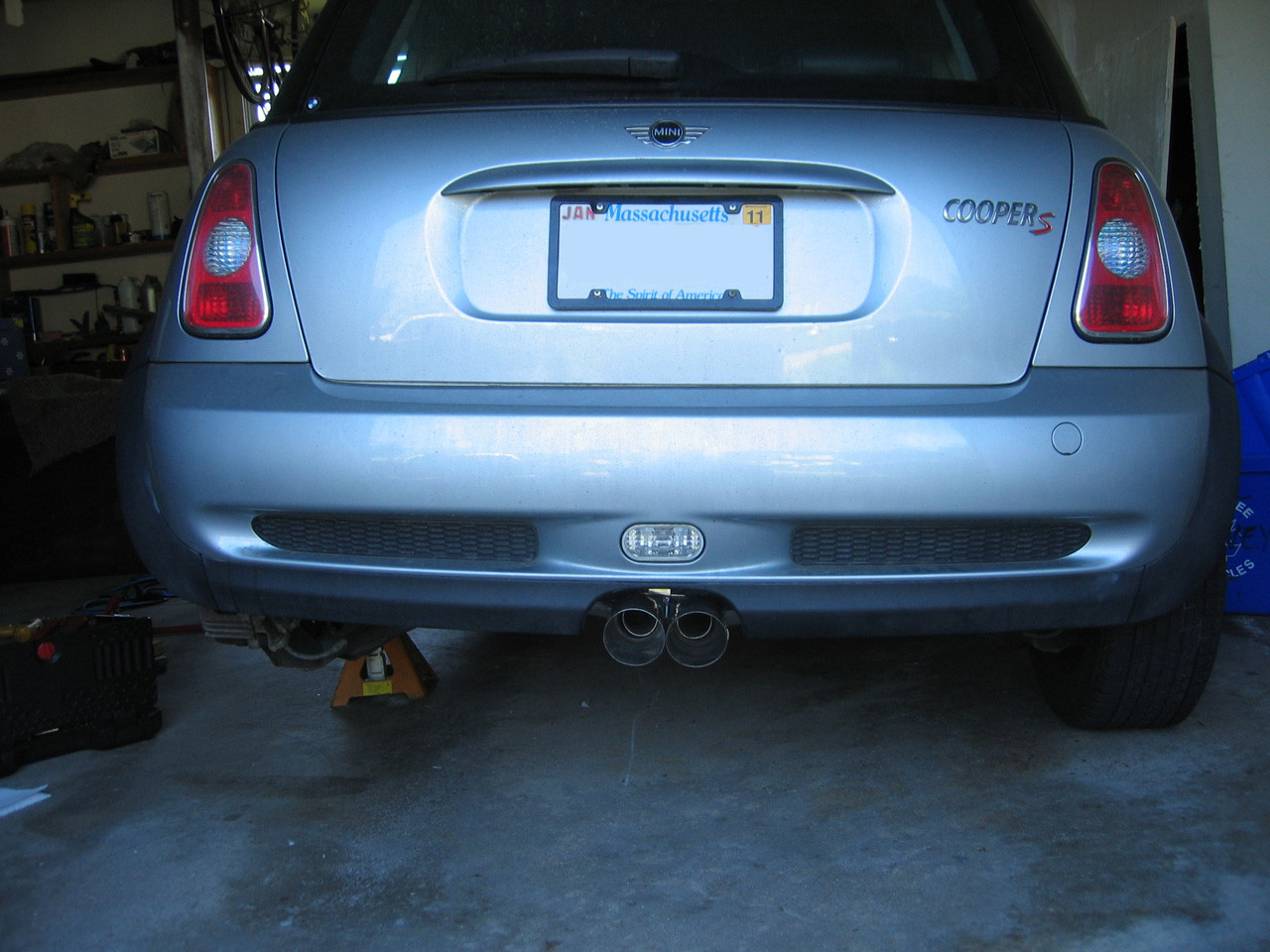

Received the Tsudo catback exhaust for my 02 MCS this morning. After unpacking it, my first impression was "this is well worth the < $300".

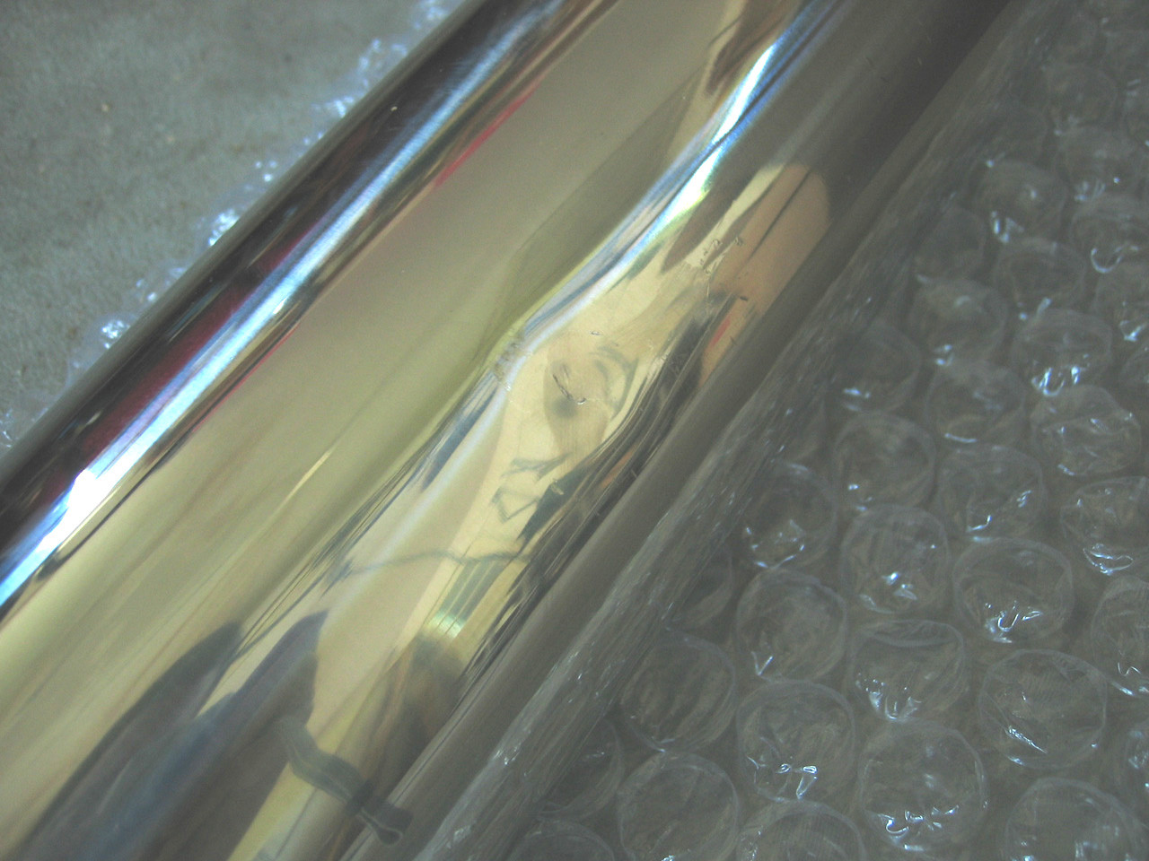

There was a slight ding in the resonator from shipping, but it's minute. I'm still going to let them know to maybe get a partial refund. This picture makes it look a LOT bigger than it is.

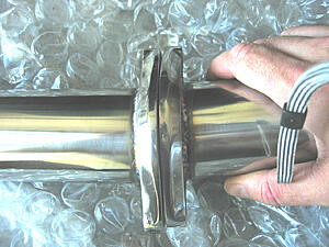

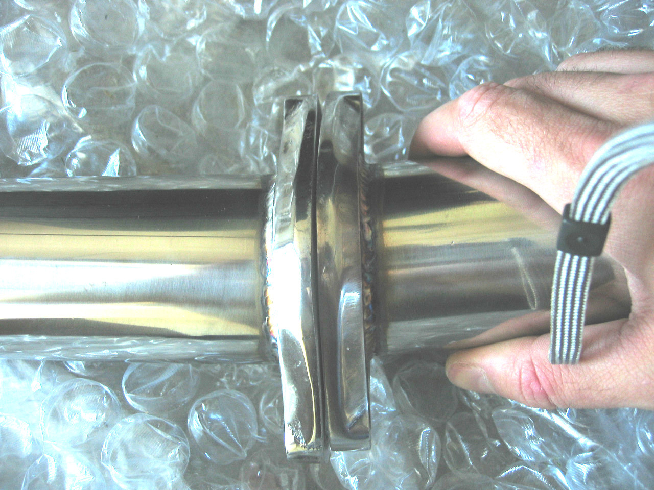

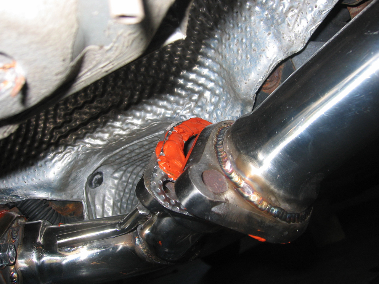

Upon checking the flanges, like many people have said in the past about Tsudo, they are a bit warped. Enough for me to run out and buy some Permatex Copper Gasket Maker. This along with the (pretty thick) gaskets that were included leave me with my fingers crossed.
It seemed pretty flat around the pipe and when I cranked down the bolts, it minimized the gap so we will see what happens. I'm still waiting for the copper to set before I turn on the car and check for leaks.
This picture also makes the warpage look a lot worse than it is, but it is still cause for concern.

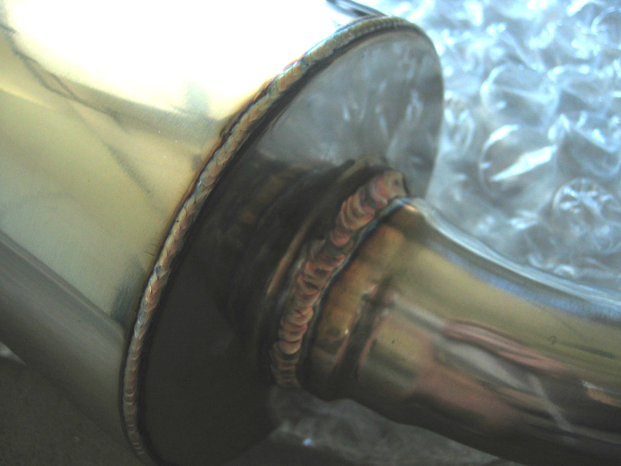

Close-up of the welds. Pretty decent if you ask me.
Here is the 3 sections hanging, but unbolted. This area was a pain in the butt to align properly, I was able to get one bolt through and threaded on each flange, but there wasn't enough threads on the other bolt for the nut to grab. I ended up using some vice grips to pull it together so I could thread it on.
Here is the hefty amount of copper I used on each gasket (both sides).
How the tips sat before I worked on them a bit. I was able to move them up slightly, but the inner hangers really need to be adjusted to pull them up. Still hangs higher than the 05 exhaust I had on my 02 .

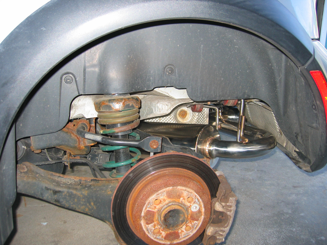

Here is everything bolted up. The main section isn't perfectly centered, but there is still a good amount of clearance all the way around so I don't anticipate any rattles.
Muffler through the wheel well.

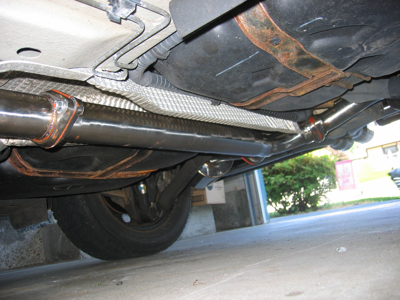

Resonator. This was the last flange I bolted up. I also had to use my vice grip technique here. I'm hoping that the stress won't cause any cracks at the welds. Only time will tell. You can see the ding here as well.
Mid-section. I bolted this and the resonator section together before I put it on the car. Didn't see a reason not to.

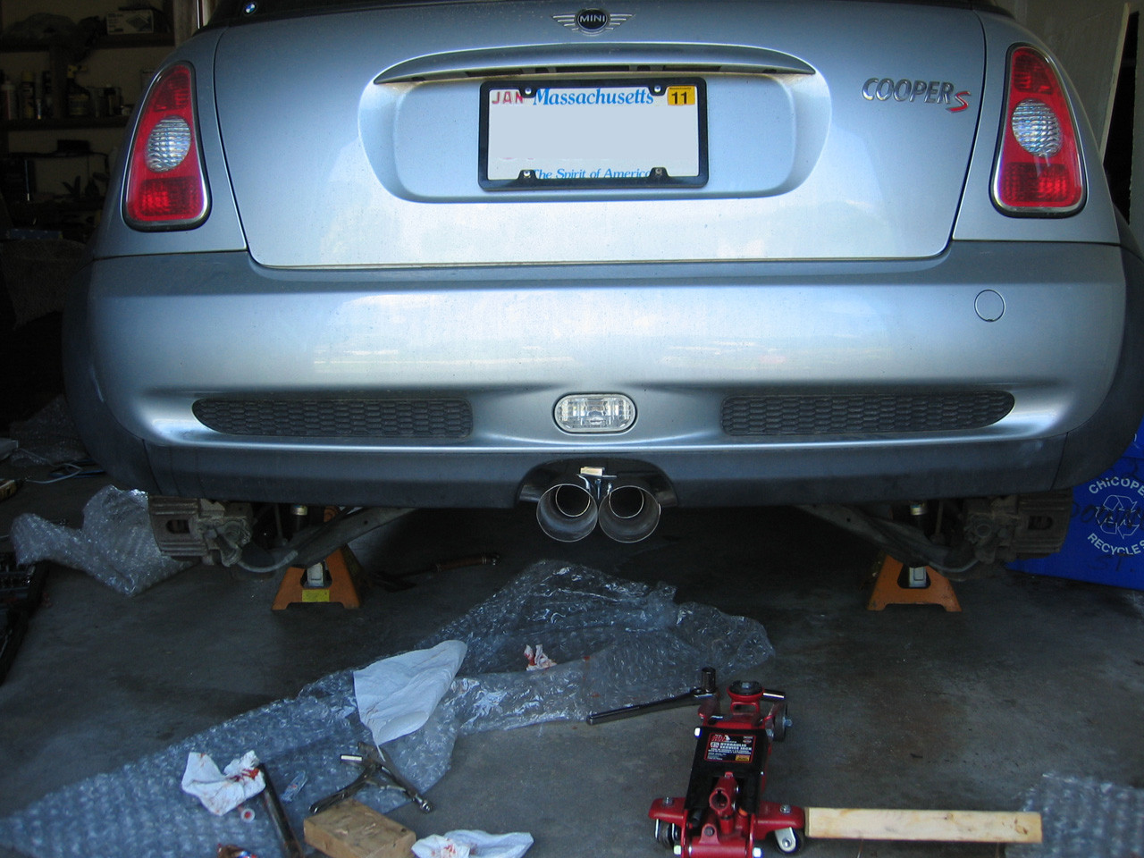

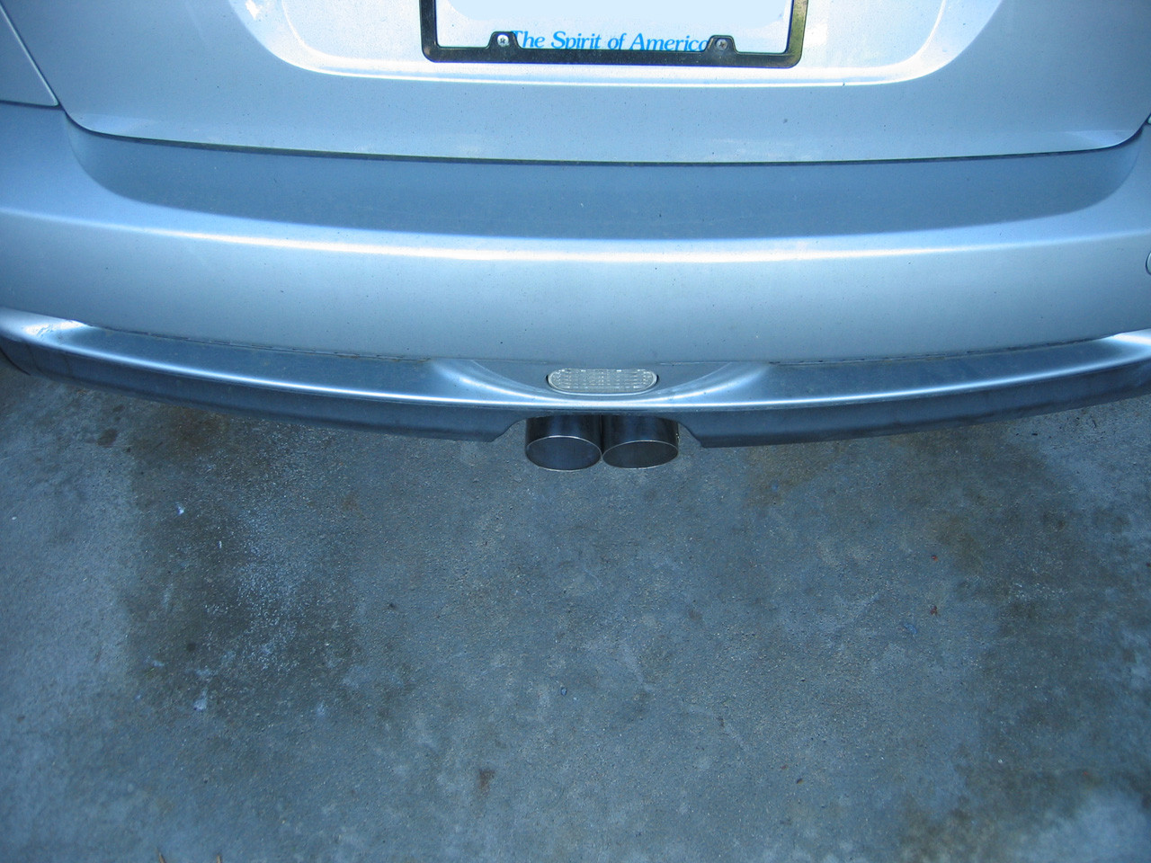

And finally, the tips. I am a little disappointed with these tips. I think I am going to do a lot of filing to make them even. While individually they look good, together they are cut at two completely different angles. I am debating painting the tips flat black as well. Still undecided on that.
Here they are after adjust them to sit higher (pretty much just jacked up the tips until the bumper started to lift. Ghetto solution, but it works .
Stay tuned for a sound review and audio clips.....

Very informative and nice write up.
I would take a disk to the tip on the left to maybe make it look more like the right. Keep working the hangers, align them - maybe while up on a lift.
We tweaked my hangers for about 20 minutes after buying new exhaust donuts for them and got those JCW tips up high and tight. Before they were drooping something terrible. Made a huge difference.
As far as paint goes. High temp black is definately needed for inside the tips where piping meets the tips. Or just throw some 380's in and wait for them to carbon up some
Looking forward to the sound clips
