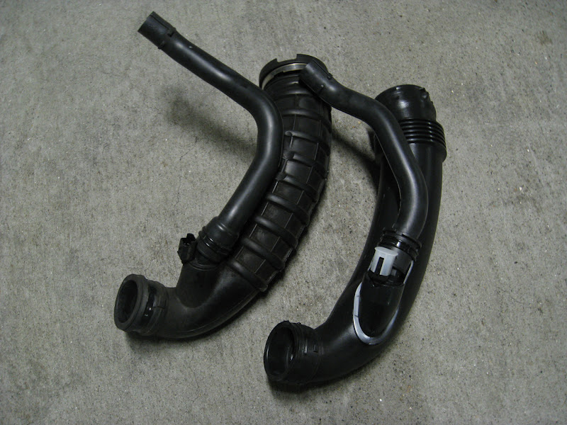

Does anyone have a picture to show the difference between stock MCS unit and JCW ?
Here you go
Stock R56 MCS Inlet Tube on left --&-- JCW Inlet Tube on right
Old May 17, 2010 | 12:06 PM
mlg2ca's Avatar
mlg2ca
Joined: Apr 2007
Posts: 103
From: Ottawa, Ontario, Canada
A picture is worth a thousand words !
Thanks.
