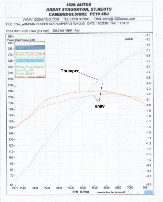

Jan here a dyno from the UK.. the power levels are BHP so they make no sense anyway.. it is the power and torque curves that are the issue!
"As some of you aware Mike sent us a head to do some testing and see what we can get out of it in the way of performance on the dyno and on the track.
As you can see from the dyno sheet comparing the RMW head and tune on Big Shows car and the Thumper head and a Chris tune on 1320’s Mini
We still need to do some more testing off combos as and when we can but we have achieved the following so far."
( Note: these numbers were with a bad ECU!)
[FONT=Arial][SIZE=2][FONT=Arial][SIZE=2][FONT=Arial][SIZE=2]( see attached BVH vs TPR-2 Head )
[/SIZE][/FONT]
[/SIZE][/FONT]
[/SIZE][/FONT]TPR-2 VS a RMW Head ...... The TPR-2 head with 15% pulley, Janspeed manifold, JCW CAI,stock cat back and newman cam - generated the[SIZE=5][SIZE=5]same [/SIZE][/SIZE]hp/trq curve as : [SIZE=4][SIZE=4]RMW[/SIZE][/SIZE][SIZE=4][SIZE=4] head [/SIZE][/SIZE]Janspeed JCW CAI 15% stock cat back newman cam combo. "
On the engine the Car has gone 12.90s with slicks in the Qtr.
0n the bottle the car has gone 11.10s on slicks
See attached dyno plot done by an independent shop in the UK !!
At this time the second fastest with out NOS is a RMW Head running a solid 13.10!!
Just me................ trying to help, but doubt if I am! Choose the combo to your application!!
Thumper

In the past 4 years there have been a few BVH's come around and all of them put out great numbers but for some odd reason when those cars with those different heads come to you they don't break 200whp. Why is that?
Also why are only RMW built (aftermarket internals, etc) and tuned MINI's making more power then cars with the same manufacture internals, different BVH which performs just as good if not better then yours, and then tuned by RMW not making those numbers.
Is that because you tune a car sub par because there aren't any of "your products" on the car?

There are two dyno graphs on this page, both show power gains at low and mid-range rpm with larger than stock valves.
