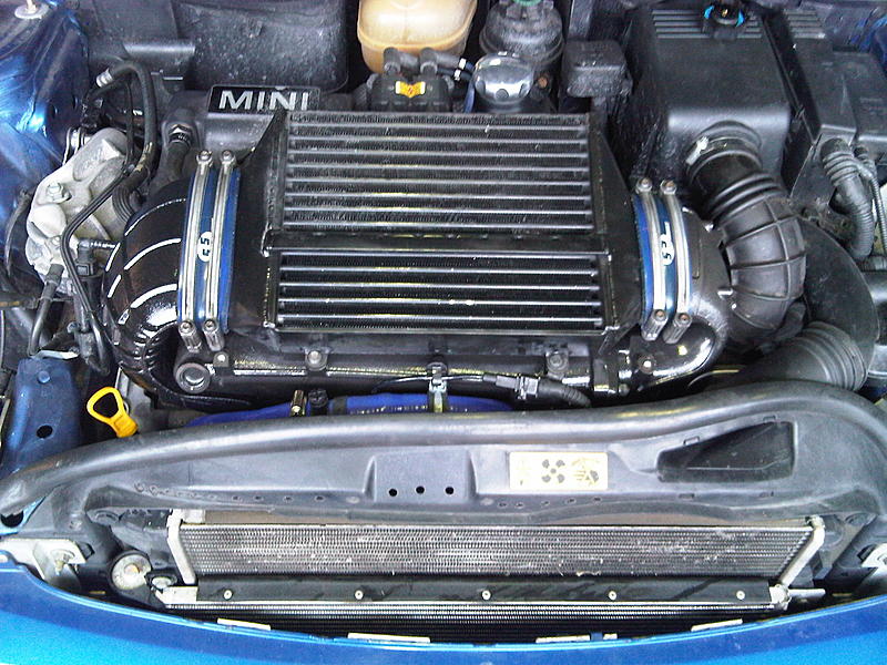

Originally Posted by scolburn79
Well their's the problem right there, being a Chelsea Fan!!!!
we all have our own cross to bear
ps to those not in the know, prodrive were doing water/meth 20 yrs ago in WRC, they do know their stuff....
