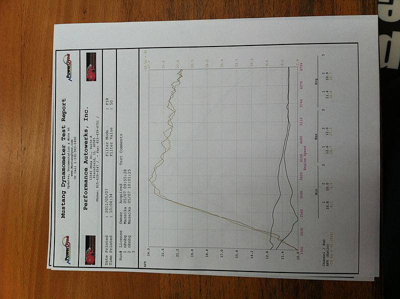

Hope this clarifies... See attachments
What intercooler are you running and how many miles on your car?

Alta FMIC. 38K. The Knock sensor voltages are good and the PCM is NOT pulling timing. Jeff recently bumped it up 2 degrees. I haven't recorded the air intake temps recently but there was only a 15 degree rise last time I checked. I may check it again because weather up here just jumped to 90.
