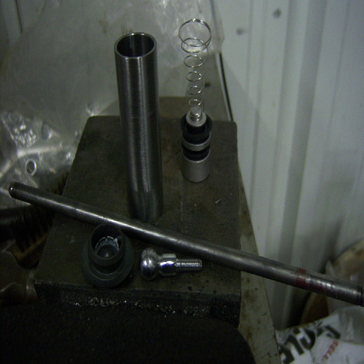

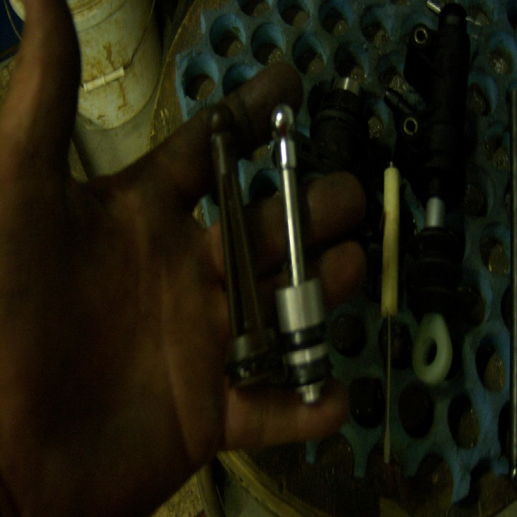

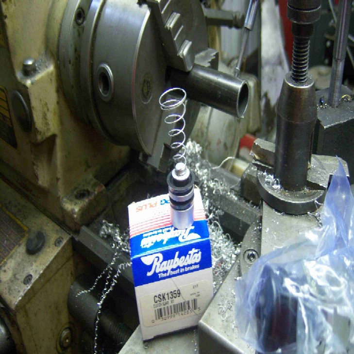

fixed today
HELP!! Damaged my transmission-size-pushrod.jpg I added 10mm more throw w/ this mod
cost 13 dollars ..Clutch releases 50 ..60 mm from floor
need lathe tho...late and Im bushed..email for picsfull size
Took longer to resize then to build the slave..LOL
yes ...IT KICKED *** adds 20% pedal effort but COMLPETELY REALEASES CLUTCH..EVEN my warped one... I decreased size of slave from 24mm
to 20 mm..13/16...Even got a big T/Y DAD! I have like 12 pics..not sure how to post them all..heres some tho..David
