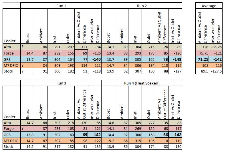

Well obvious to me which cooler is best and your not even using the latest version (extra diverter) and there maybe an even newer version on its way.
Done an easy to view table from the figures
Originally Posted by roggenmini
Is this the Water to Air that they have on their site?
No its not the W2A on his site It performs better than the A2A
Its also not the new front mount he's working on
Its a development to his top mount intercooler for the MINI. Just needs to see if it makes any difference

Great chart, thanks for putting it together
I'm somewhat of an excel noob... learned it last night when making these charts

Your welcome, just can't get it to display as a BIG picture, I've forgot how you turn the attachment link into a link that works for the IMG tags
