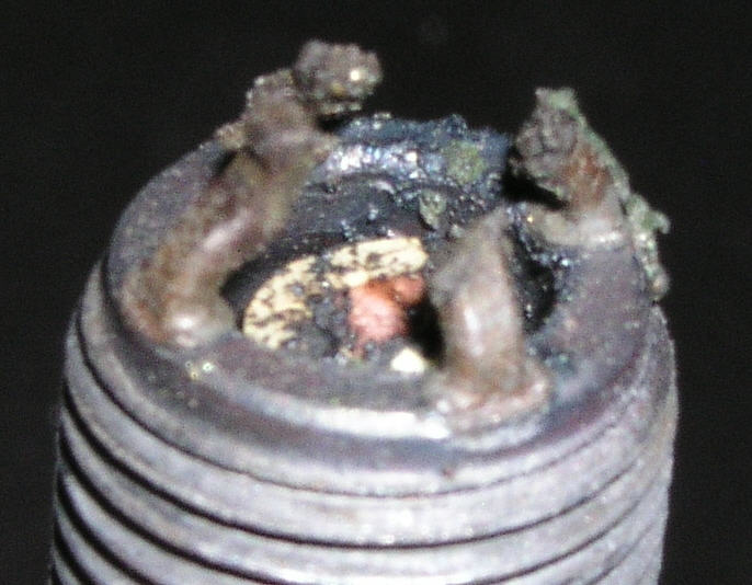

Driving in to work this am check engine light comes on and throws P0303 code.
Pull plug on cyl # 3 and the entire center post has fallen out and disentegrated.
Compression check on cyl 3 is 0.
What's the easiest way to tell if it is a head/valve issue or piston without completely tearing the head off? Or is that pretty much impossible to tell without taking the head off.

what was the compression in the other cyl.? or did you discover the bad plug and immediately throw your gauge on it ? just thought maybe to check the gauge . 0 is awful . that's like a hole in piston type territory . sorry to hear it ,.
I had low compression on cylinder#4 80lbs verses other cylinders being 130. thought we cracked an exaust valve but when we got the head off the piston had a chunk missing from it. this was due to running lean. had lots of mods, but no higher injectors to compensate
A 0303 is a misfire, you knew that, but, it is suprising there were no other codes.
Any piston damage from detonation will leave some evidence on the plug. A valve or seat would not.
You would think the upstream o2 sensor would have detected a lean condition before this failure. A valve or seat would not cause a lean condition = 0303.
Either way the head needs to come off.

Oh Sh*t mate -- hope I'm wrong...
Ouch ouch ouch.
I'm afraid that looks like way too much heat and shock to be ought but severe detonation. That tells me that my hope of finding a burnt valve seat or something jamming a valve ajar was too optimistic.
I'm very sorry to say that I expect when the head comes off you'll find the need to at least replace a piston.
I am stunned by the damage, the symptoms, and the very short time frame. The only thing I could imagine could cause such a selective and immediate failure would be a clogged or problematic fuel injection nozzle. In such a case I could imagine an extreme lean condition arising fairly suddenly.
Ouch again!
Hope I'm wrong.
Ouch again!
Hope I'm wrong.
That plug was WAY hot.
If you look at the melted parts on the end of the plug there is more material than just the plug. There should be some aluminum, in the mix, from the piston. cmt52663 has a good theory in that the #3 injector failed, have it tested, I'd bet it's bad. Are your injectors JCW's ( 380 )? I am assuming they are from your sig.......
The bad news is you need a piston. With some luck the cylinder wall is not damaged ( this would happen if the ring lands melted & left the ring to score the cylinder ). By the looks of the plug, the heat was in the center of the combustion = hole in the piston.

look at the oil also and see if it smells like raw fuel. if you have a big hole in the piston, it will be just dumping fuel into the oil pan. it looks like you are going to have to pull the head to see what is going on, but a bore scope will help without pulling the head.
but a bad valve will need the head to be removed. if you have to replace a piston, replace all 4 with better ones and depending on the miles, your better to replace the bearings and upgrade to some ARP rod bolts.
"if you have to replace a piston, replace all 4 with better ones and depending on the miles, your better to replace the bearings and upgrade to some ARP rod bolts." very good advice.
Either way, the head is going to come off. Unfortunately I don't think there was a valve failure, there is too much evidence on the pulg that suggests piston.

A Friend lost number 4 cylinder!! dry was 40 psi/wet was 60 PSI!! He NEVER went to a colder plug when he went to 17% boost!! He has a CAI/ cat back exhaust ported head..blah blah!! The issue here is you have to drop the heat range when you boost!! HAVE TO!! colder t-stat also, and get a read on your a/f!! Not that this was your issue... but detonation will kill ya!! yes??Just me..........................Thumper
other 3 plugs had minor damage.
I have the unichip with a tune for jcw. CAI and larger intercooler.
I don't have the jcw injectors since mine aren't blue in color but tan.
I belive the pistons are probably shot so I've contacted Webbmotorsports and will get it in to him for complete diagnosis and repair.
I agree that it probably isn't the head now.

With a JCW tune you need the JCW injector. This would be the "how". The "why" would be the duty cycle of the "S" injector. The plugs were also a big contribution as they ran much too hot. It's strange that there was no run on after shutting the car off. Those plugs got very hot........
Why the ECU did not see such a lean condition is of note. The EGT had to be way high given the look of the plug posted. There should have been a code & possibly "limp mode".
Possibilty 2:
When the engine is taken apart look for an air intake leak. A broken hose, old cracked hose... This failure, as you describe, is more sudden than the spark plug is telling me & the ECU reaction is not what I'v seen.
You'll know more after you get it apart. If it's not too much trouble have the injectors tested.
Possibilty 2:
Ouch! Confiming what others have said:
1. Lacking adequate injection was the primary cause of failure.
2. The warm plugs contrbuted significantly.
3. The bore scope will help you determine the extent of the damage, but you might as well just start pulling pieces. At the very least either the engine ore the head or both will need to be rebuilt. With the detonation you have experience (not to mention the big chunk of spark plug sucked into the engine) at least one if not all of the pistons will need to be replaced.
You might want to consider a used engine salvaged from a wreck. Or if money is not an option, pull the engine and have it built into a monster by a good builder.
