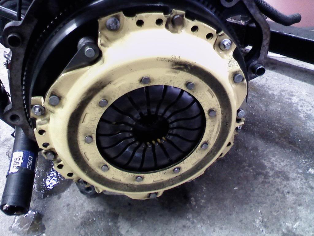

only 200 miles on the clutch and man is it dirty...

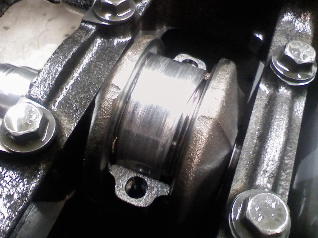

All rod bearings are shot.

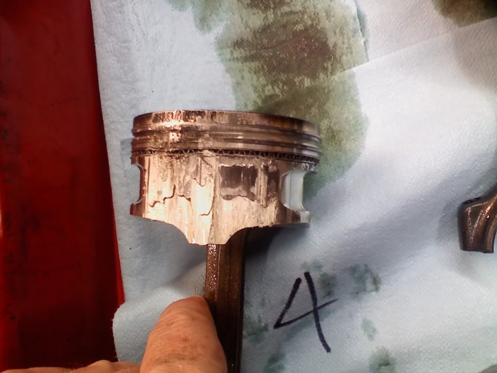

Cylinder #4 piston is shot, all others are fine.

All rod lobes on the crank look like this. The crank will need turned, hopefully it will still be within spec. The main lobes where all ok but you can see they were just starting to wear.

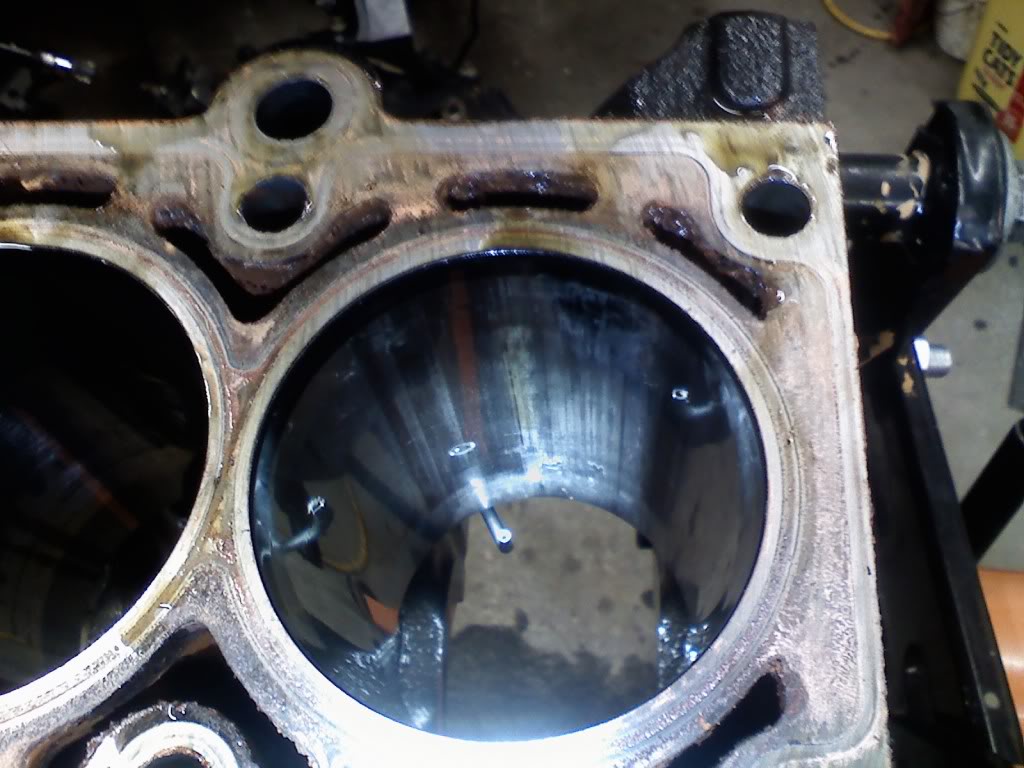

Cylinder #4 doesnt look bad. .020 over bore should be fine, but will know for sure when I take it to be machined.

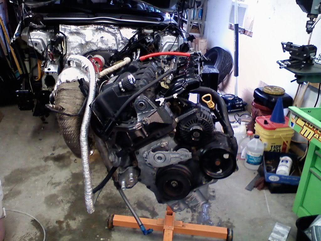

all the engine internals out of the case. Need all new bearings, rods, pistons, & crank turned & cylinders bored/honed.
