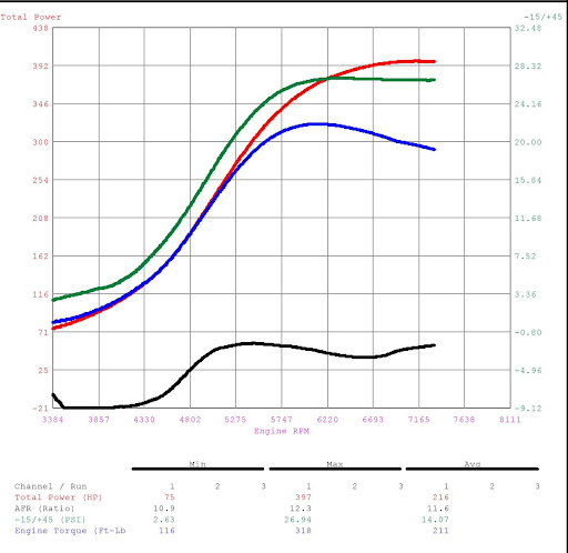

Most I was willing to push on stock engine. Boost was 26/27 PSI, as Ryephile mentioned, the limiting factor is the stock pistons.
GT2871 TURBO CONVERSION
STOCK HEAD/BLOCK
CUSTOM INTAKE MANIFOLD - TUNED RUNNERS W/VELOCITY STACKS
FRONT MOUNT INTERCOOLER
CUSTOM FUEL SYSTEM - RETURN TYPE
RACE GAS: VP MS109
STOCK HEAD/BLOCK
RACE GAS: VP MS109
Is it really safe to run that much power through the stock pistons? I'd be afraid they'd blow every time I got past 4k RPM's .
It's more of an illustration point
