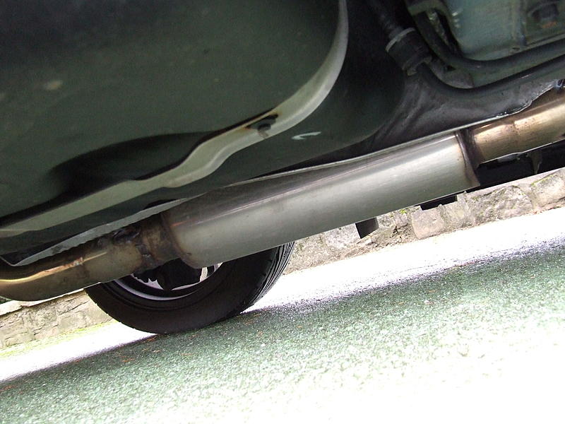

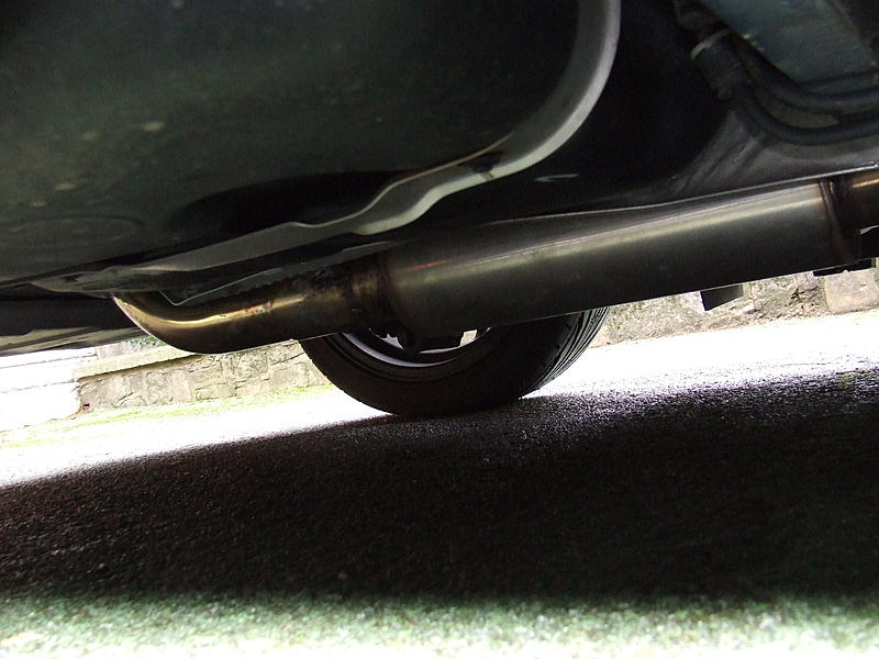

pictures of volt resonator for ofcski
Hi ofcski resonator pictures as requested

Looks like it sits kind of low. Is that the Volt resonator or the additional one?
Old Nov 4, 2008 | 11:55 AM
#Dragon#'s Avatar
#Dragon#
Joined: Oct 2006
Posts: 266
From: uk
the additional one
Old Nov 4, 2008 | 12:49 PM
zeus7625's Avatar
zeus7625
iTrader: (7)
Joined: Sep 2007
Posts: 265
From: So far south in AL, one more step and I'm swimming (in oil)
From the pics it looks like the new resonator may not have much clearance from the heat shield. Since the only two hangers are right behind the cat and between the rear tires, your new resonator may be vibrating against the heat shield. The solution then would be to have a muffler shop install an additional hanger somewhere close to the new resonator.

hi zeus,the resonator is not as big as it looks in the pictures and i was using a zoom lens to take the photo and iwas parked on a tarmack ramp to take the shot. tha last time i looked the clearance was ok.
