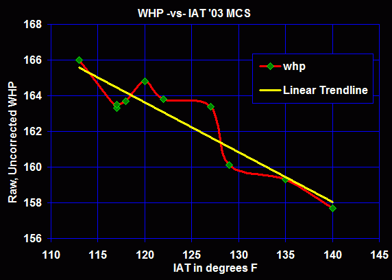

>>Air temperature in the intake manifold has a clear (at least to me) correlation to horsepower:
Right on. About a +/- 1.5% change in horsepower.
And fitting a straight line to that data:
You're the greatest.
And we all know how you can't make CAUSAL conclusions from CORRELATIONS
right??? You are implying that the intake temperature is responsible for the
horsepower changes, and you simply cannot state that from just this graph.
Here's a classic: Ice-cream sales vs. murder rate.
Lower ice cream sales = lower murder rate. Higher sales = higher murder rate.
So, do ice cream sales increase the murder rate? Of course not. They both go
up and down with air temperature. (HEY! just like horsepower
So, graph what you want, and I agree that cooler, denser air will increase the HP,
but this is soo far off the track from running a cooler plug in the summer it's
not really worth either of our efforts is it?
)So, graph what you want, and I agree that cooler, denser air will increase the HP,
up and down with air temperature. (HEY! just like horsepower )
BTW, I never said "colder" plugs were needed, simply that your "1.5%" rule of thumb is false. Do some research on the nature of forced induction engines and elevated manifold temperatures before spouting nonsense. If you would actually care to see the rest of the data logged during this session (ECT, etc), feel free to let me know, Please be aware that the results may not match up with your misguided preconceptions.
