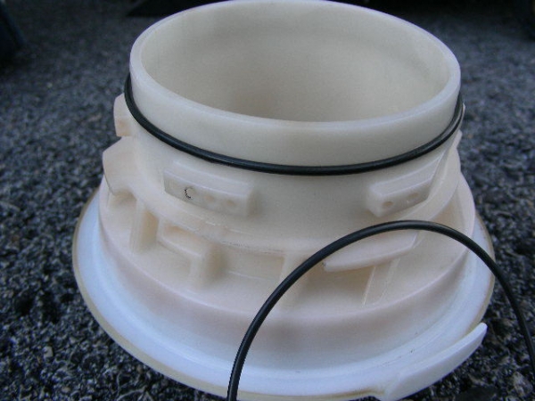

I was able to get the locking hub on and secure However, the car wont start with a half tank of gas. I've tried the advice from another NAM member... "turn the key to the second position about 5-6 times in order to pressurize the system" trick but that doesn't work.
i had trouble here as well , what went wrong was when i tried MANY times to get the white filter housing back together one of the O rings came out of place inside.
pull it apart one more time and make sure they are all in place. you do need to push real hard on the 2 parts of the white filter housing to get it close enough together in order to give it that twist into place.
if it is put together right , you will hear the gas being sucked into the filter the first time you turn the key. it will sound diffrent than what you hear now.
the car started no problem after that.
good luck

I'll give it a shot. Just put another 5 gallons in and now its at the full line so I know thats not the problem. Back in a minute or two......
Old Dec 23, 2009 | 10:10 AM
  #38
DMBFan2's Avatar
DMBFan2
Joined: Jul 2009
Posts: 385
I found the problem............ It was inner large O ring. During one of the MANY times that I took the canister out and removed the filter the bloody Oring inside the canister came off.....
Now I can go to work today.........
Thanks for your help..
