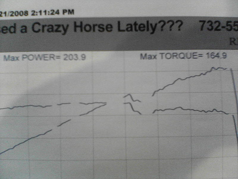

I went to the dyno at Crazy Horses in South Amboy and i put down 203hp and 164tq. My air fuel was 14.8 I'm kinda of nervous about that. I'm going to buy JCW injectors right now and hopefully that will fix my problem.

why be nervous...i rather be rich than lean. ur a/f should be tuned to your mods with the MTH program so i dont know why ur running rich....and if ur getting injectors id rec 400-440 rather than the jcw 380s being you have a 15% pulley with a 2% crank

I think you're mistaken. 14.8 is super lean as the number goes down it becomes rich. Oh yeah, the MTH was done when i just had the 15% pulley and nothing else.

nice looking graph matt ! It would be cool to try a few runs without the water/meth just too see the difference if dyno time werent so expensive

I told Kelly we have to frame it because it's a $100 picture She gave me the look of death!!!

ur right...i got that backwards....oops....what plugs u running?

i have the ngk step down plugs for the higher boost.
