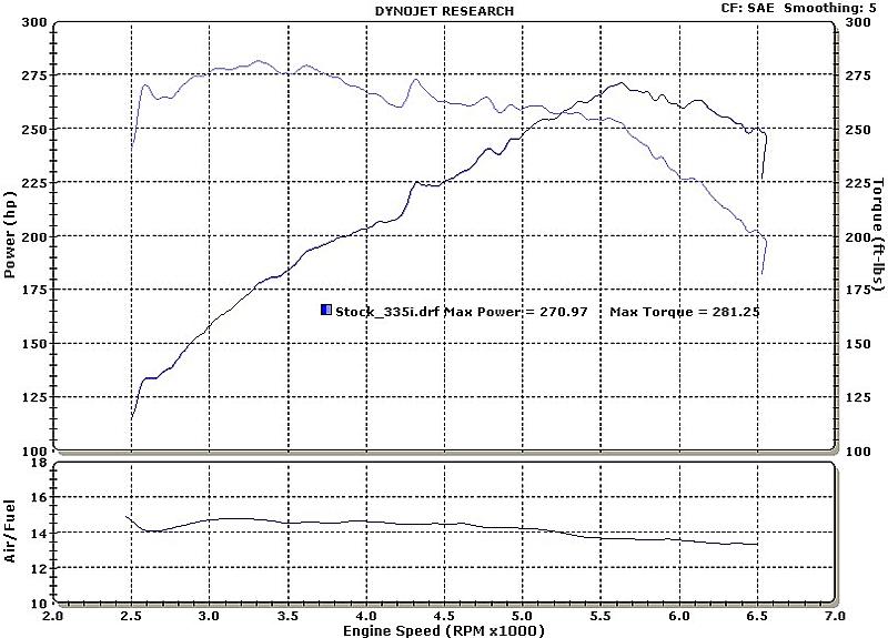

Those air/fuel ratios look very strange. Is it possible there was an issue with the sensor or placement?
Attached is a stock 335i graph with air/fuel for reference. I would expect to see a similar curve, 14.5:1 in the midrange down to 12.5:1 up top. But to drop off the scale seems very odd.

Sensor was on tailpipe with innovate clamp.
BTW from the looks of the graph you posted it looks like it stays on top at 13.5 - 13.0 not 12.5

That particular dyno just reads a bit lean, probably needs a new sensor. But the 335i air/fuel ratios are generally 14.5 mid down to 12.5 up top. On the JB2 we remap them to around 13.2:1 mid down to 12.0 up top.
Have you seen any other R56 dynos with air/fuel ratios, to determine if yours is normal or not? I would expect all air/fuel ratios from different runs on the same day to be grouped pretty close together.

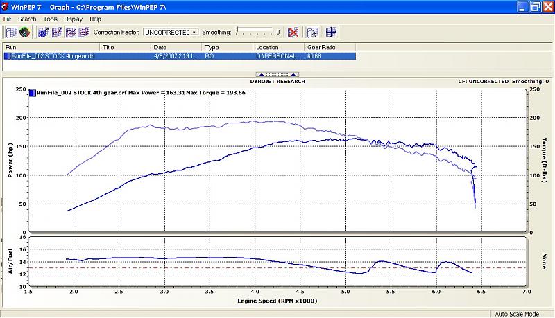

OK just did a quick search and found more wacky air/fuel curves! So this begs the question, are the air/fuel ratios really jumping around like this, or is there an issue with how we're reading them.
Two of the charts look like 14.5:1 in the mid down to 11-12:1, which is what one might expect to see. But the first?
Attached Thumbnails Burger Tuning-2007-r56-stock-4th-gear-uncorrected.jpg   Burger Tuning-r56sjcwdyno2.jpg   Burger Tuning-dyno2.jpg
