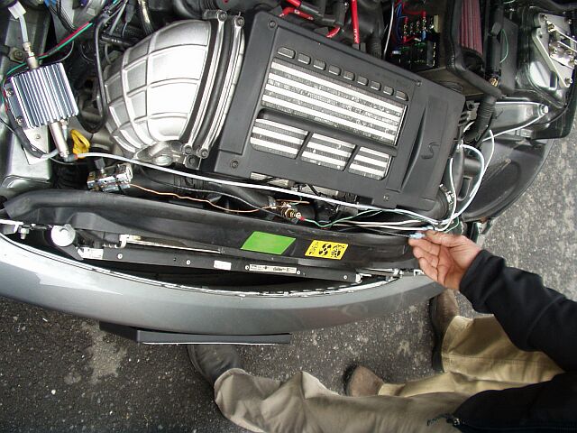

I saw in another thread that you had mentioned using a water injection system from Aquamist.
I am currently using an Aquamist system on my turbocharged motorcycle in lieu of an intercooler. I can testify to the units build quality and function.
My question is what benefit do you think 02 injection would play with the MINI?
Considering the boost levels being run, even with the pully mod, do you think pre-ignition is a concern?
I would imagine the intercooler should keep incoming airtemps below the detonation point if premium fuel is used. Do you plan on running higher boost levels?
Ive got an extra Auqamist pump laying around. I wouldn't mind hooking it up if there was some benefit. Was wondering what you thought.

Given that Randy is getting a power increase with the bigger intercoolers, I would expect a similar benfit from an H2O setup; assuming you mix it with some alchohol.
If possible, I would install the injector after the throttle body; I had problems with the throttle sticking closed with the injector before the throttle on my M3.
Give it whirl!

jlm has water injection in his MCS:
IIRC, it did absolutely nothing for power.

the last time i had the car on the dynol, we did A/B runs, the only change being water injecting at >10psi boost or not. We saw no change in the dyno readings.
My conclusion was that my car had not been detonating without the water, hence the knock detector/ecu hadn't meddled with the timing, so we were avoiding a non-problem with the water.
As with all the tests at Helix, water and intercooler temps were monitored and runs made only when the temps were the same (intercooler at 130degrees)
as far as mods, my car had the BMP cam, 61mm throttle body, Supersprint header, newest Evotech chip, Rogue cat-back exhaust and 15% pulley mod (16psi max boost). No alky in the water. Uou would think this baby would kick butt, but...
My car barely put out as much as Andy's run the same day (same 15% pulley, but magnaflow exhaust, no cam, no header, no chip, stock throttle body)
