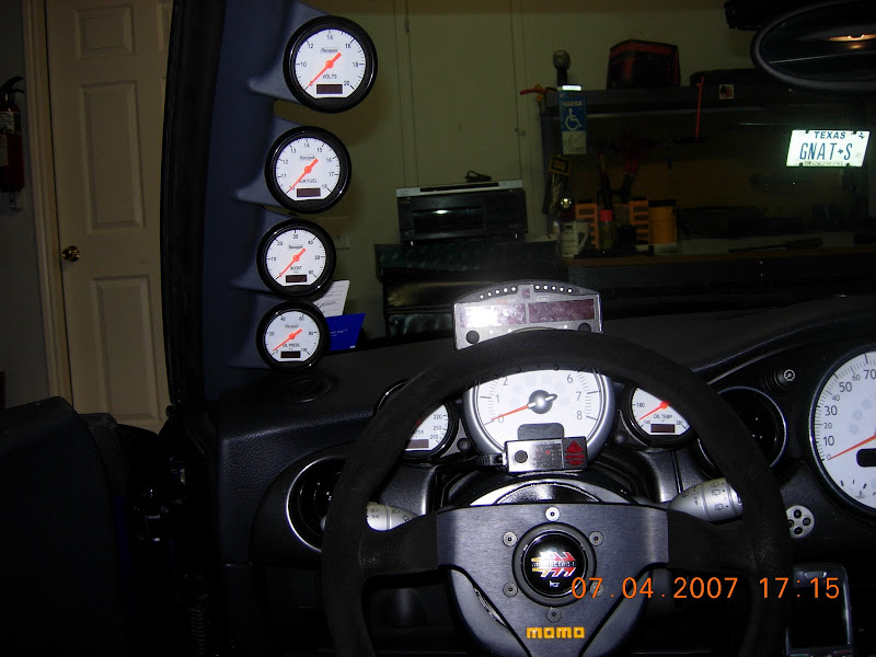

If I bought one of the pillar pods that goes on the piece to the left between driver's side window and windshield how would you wire everything? Where would your run the wires?
Has anyone every done one of these pillar pods and if so pictures and HOW TO'S are greatly appreciated!
This pillar pod is custom but is along the same lines, just a little bigger. Wiring is no different then any other electronic gauge set, only run to a different location.
When you pull the A Pillar start from the top, there is a strap connecting the pillar covering to the frame to limit movement in the event the side curtain air bags are needed. Take the side panel off the dash to fish the wires up to the pillar cover. Drill small holes in the cover to pass wires to the gauges.
