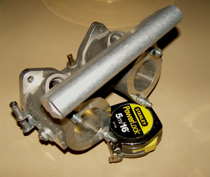

See pic - I have a couple of these I want to get rid of. These were made by TWM many years ago ( they were for my Spitfire ). For some of us that had carburator cars these were the bee's nee's. These with a stand alone & a lap top..... NOS..... that's what I'm talking about....
Obe - if your Merc was a fuel Injected car originaly.........
