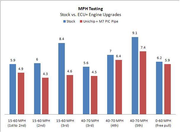

We all know that you don’t drive to work on a dyno… Numbers are impressive, but what happens on the road or on the track is what’s important to most people. Along with the dyno testing, we took the car out and tested how the two new products affected the car’s ability to perform in real world situations. For these tests, we wanted the conditions to be near similar to cut down on any data-altering variables. Both sessions were conducted on the same grounds with 85º ambient temperature. We had the same 2 people conducting the tests with ¾ tank of gas each time so that the weight during both tests was the same. No suspension changes were made during testing and both were conducted on Falken Azenis RT-615 (215/40/R17).
The first test was done with no engine modifications to the vehicle and is represented by the blue bar in the following graph. The second test was done with the Unichip module and M7 PIC Pipe installed and is represented by the maroon bar in the graph.
As you can see, the two products installed had significant effects on the acceleration of the vehicle throughout all of the speed and gear situations. Behind the wheel, the power band feels wider and thus power is more readily available than before. If you were impressed with the power numbers presented earlier in this post, you should sit behind the controls of our test car! The torque is absolutely amazing! Basically, slam your foot down and you’ll be planted into the back of your seat. This really affected our 0-60 MPH test from a dead stop and moving through all necessary gears. There was so much torque going to the wheels that we had some difficulty getting the tires to hook up with the pavement. Of course, some of you with more drag racing experience may be able to experience better results (just make sure you’re doing it in the right place!).
These two modifications have not only shown what we MINI owners want to see on paper (positive numbers!) but they get approval from the butt dyno as well. Our changes so far have put a permanent grin on anyone that experiences the new power in our test car.
