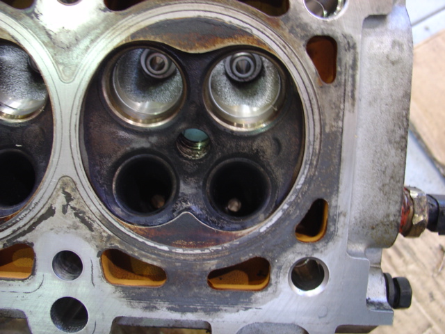

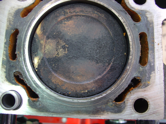

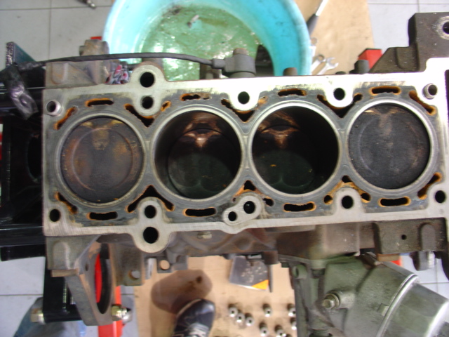

also pls see my head. anything wrong with it? they said i need to replace piston, connecting rod, valve springs, retainer etc. almost everything needs to be replaced. very $$$$$$$

Your bottom end looks fine....you can see it runs rich by just looking at the pistons. Dont go by reading the plugs, I can pull my plugs and they will look the same as yours, but I monitor my A/F ratios with a wideband o2 gauge. If you dont want to install one, just run it on a dyno that can read your a/f ratios & rest well.
As for the head, I would buy one complete from someone reputable in the MINI buis. I went with RMW for my head needs.

i went down to the shop last night. the guy claims the valve springs are a bit loose/worn out. also he can rotate the pistons a little bit (maybe 1.5mm by the look). to me, quite sensible for a 4 yrs car.
i think i may replace all valves, retainers, pistons etc with stock just for peace of mind. personally i don't think i need racing kits. a ported head may just do the job well...

Your stuff looks just like all the othe Mini motors I've looked at.
but that said, the issues on wear can't really be seen by eye, and can only be know for sure by measuring the parts.
All supercharged MCSs run rich. They use extra gas to cool the chamber. But I think you'll find stock replacements ususally cost more than performance parts!
