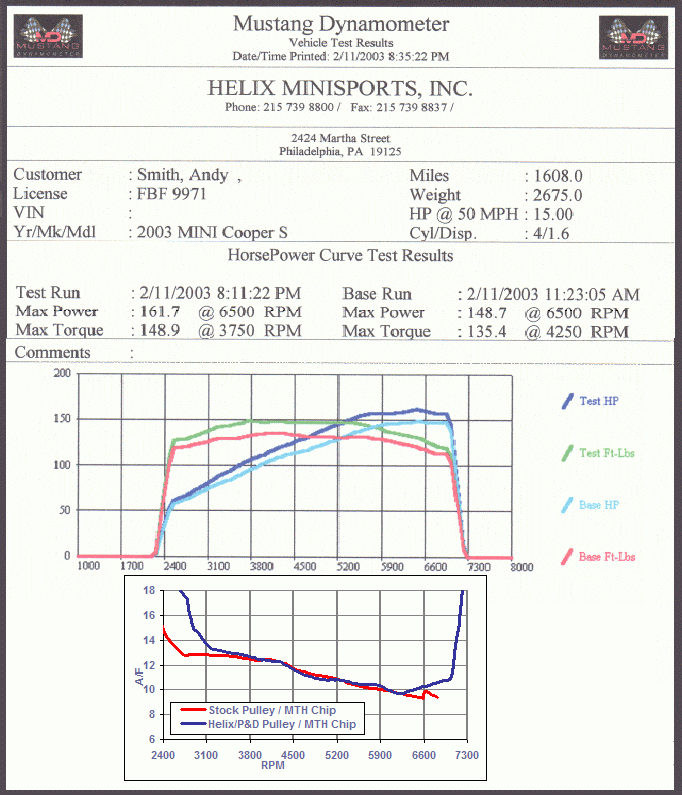

Here's my before-and-after results (with both stock and MTH chip). Torque and HP gains were very similar:
Was the rest of the car stock (no mods to intake or exhaust)?

We see pretty consistent numbers - usually the gains in torque are 15 ft-lbs. I have seen as low as 12 and as high as 23 (!).
The 23 ft-lbs was on a car that before the pulley had the Madness intake and the Borla exhaust, and in addition to the pulley, we changed to the Magnaflow, so that 23 includes the gain from both the pulley and the Magnaflow. Without the exhaust change, I'm sure the number would have been more in the mean of 15 or so.
I have seen dyno numbers from 15 or so cars, so that number I'm pretty confident in.
