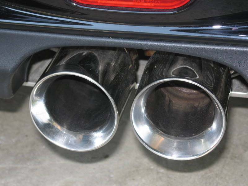

Old May 31, 2007 | 08:29 AM
MINIFVR's Avatar
MINIFVR
Joined: Apr 2007
Posts: 1,178
From: Outside of Phila, PA
First? Review:  TC Sportline cat-back exhaust-img_0786.jpg
First? Review:  TC Sportline cat-back exhaust-img_0798.jpg
Click to enlarge.
For the doubters...
RedSkunk- I hope this helps....

Old May 31, 2007 | 09:18 AM
RedSkunk's Avatar
RedSkunk
Joined: Sep 2005
Posts: 1,111
From: MINIapolis
It's actually comforting to hear that yours needed to be cut and "rearranged" a bit too, because I started getting worried (and angry) last night that my place ruined the exhaust permanently by tweaking the passenger side muffler.
I'll be dropping it and tweaking next week. Mufflers look about identical. Pretty sure I can get it much better with some tweaking. Plus it DOES sound great and the car feels quite a bit better.
