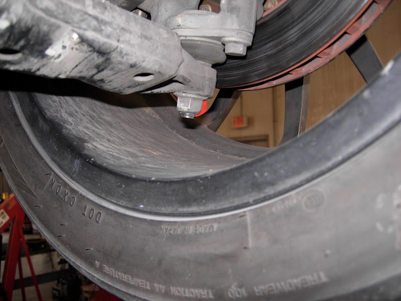

The suspension drooped causing the bolt on the bottom of the A Arm to dig into the wheel, splitting the wheel in half.

Even the A Arm bolt that dug into the wheel came out unscathed. I figured this was going to be a rounded off mess.
A-Arm Bolt
A-Arm Bolt
