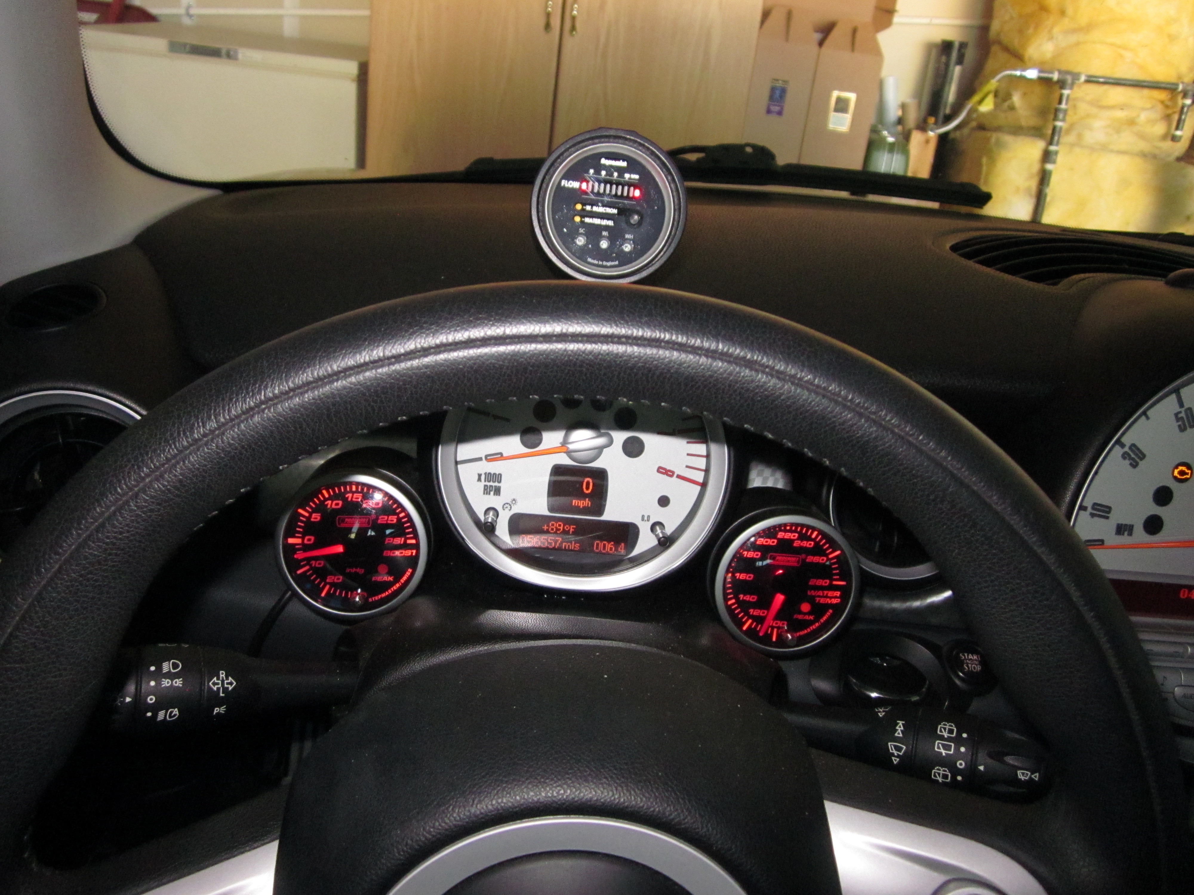

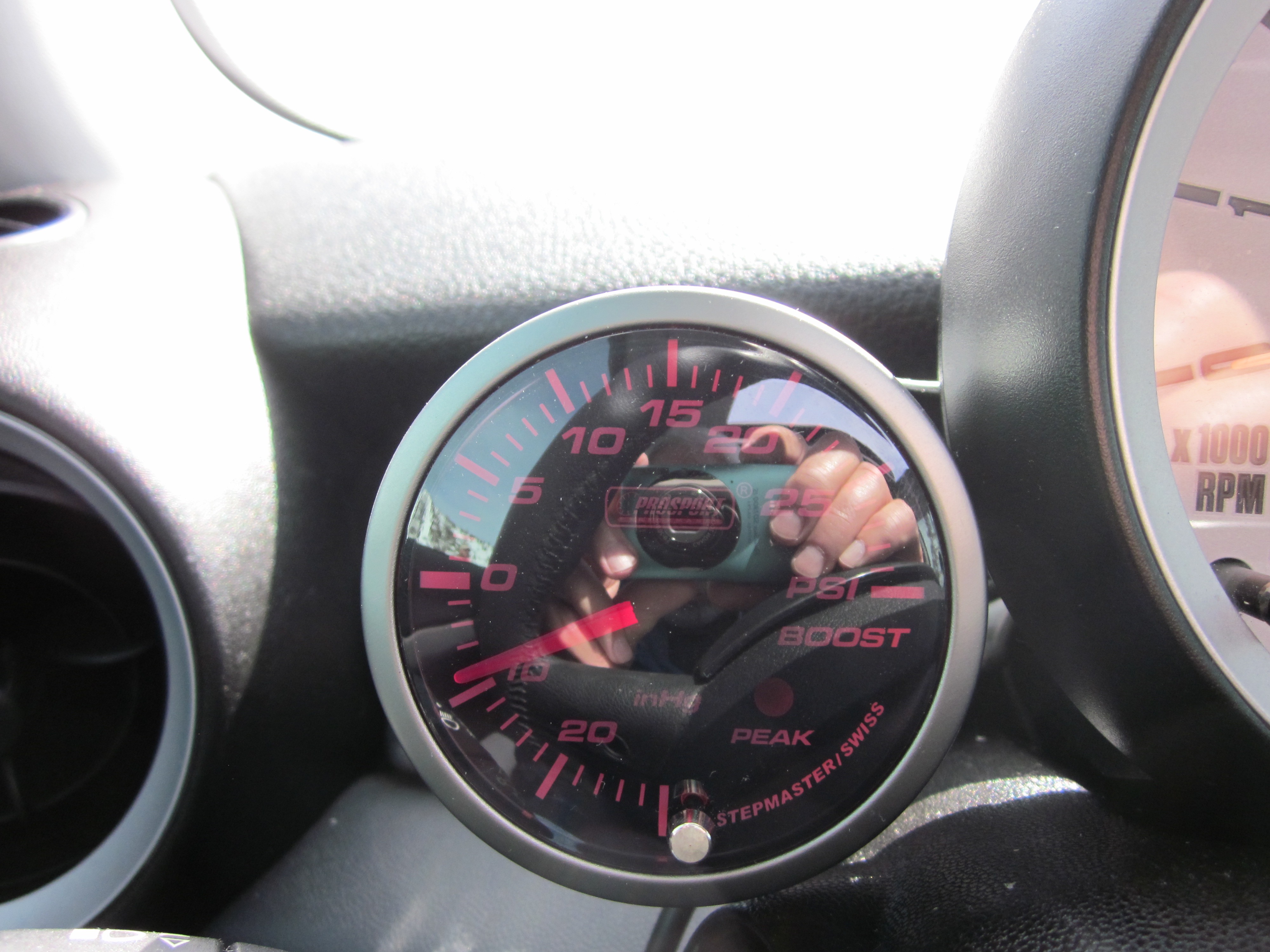

I've taken a pic of my boost gauge --- ignition on, engine off, at both my home (4500') and at a rest stop on one of the Sierra Nevada mountain passes (about 9000'). Poor quality pics, and the scale is in inches of mercury, but it shows where boost starts. Around home, when boosting at 30PSI, the gauge is starting at 5inHg (the equivalent of about -3PSI), so 30PSI is indicated as 27 on the gauge. Even tho the gauge shows 27, the turbo is actually providing 30PSI, and it's relative to ambient atmospheric pressure. My waste gate is controlled by an external manual boost controller, nothing to do with the OEM WGDC valve.
