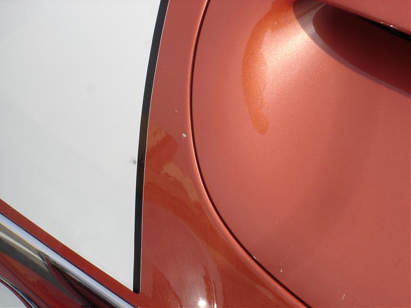

Ok.... So I got my first rock chip Now what? I've read several threads via the Forum Search - but am looking for very specific details on how to make my Mini all better Please Help?!
Attached Thumbnails 1st Paint Chip..... Now what(?)-dsc09826.jpg   1st Paint Chip..... Now what(?)-dsc09827.jpg

Here what I did. First I went to BMW and got some touch-up paint I think it was like $18. Then I went to Langka and got their chip kit ($26 I think). When it came it had the cleaner, a chemical, some very tiny brushes and a scraper looking tool.
I cleaned the chip using some 3M wax remover and then used the Langka cleaner. Then I used a toothpick and blobbed some of the touch-up paint into the chip. I wanted to get it in contact with the edges, but I also wanted to leave it raised above the undamaged paint. Here was the hard part - had to wait like 2 or 3 hours for the paint to dry. Then following the Langka directions I put some of their chemical on a cheap microfiber glass cleaning cloth from target and wrapped it around the supplied scraper. Then you start smoothing the blob of touch-up paint down until it is even with the rest of the paint. I then used one of their very tiny brushes to apply just a tad of clear cost that came with my touch-up paint. I then let it dry a couple of days before waxing that spot again.
The nice thing about this product is that you end up with a totally filled chip that is even with the rest of the paint. You can't even tell where my chips were. Downside is that the Langka chemical smells like lizard puke, but it works well.
Hope that helps.
Chuck

i would get a tooth pick and pick at it until your car is silver. jk
try Minimaybee's idea, then also try getting touchup and applying it with
a toothpick with the tip flattened a tad.
dont brush, use capillary action.

MiniMaybee - Did u need any special tools besides what came in the kit?

I did exactly what MiniMaybee did, and it was a huge improvement (there were about 8 by the time I got to it) . The smallish ones were totally invisible - the biggest was detectable if you knew where to look.
Just the kit, cheap microfiber and the high-tech, solid wood toothpick.

Touch-up paint and Langka work wonders.
For larger chips, the paint applicators (mini Q-tips) that Langka sells are great.
You should be able to get at '95% gone' repair w/ Langka and MINI factory touch-up paint if it's a non-metallic... maybe a '85% gone' repair if it is... the metal flake just never lays down the same way w/ the touch up.
