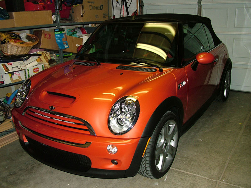

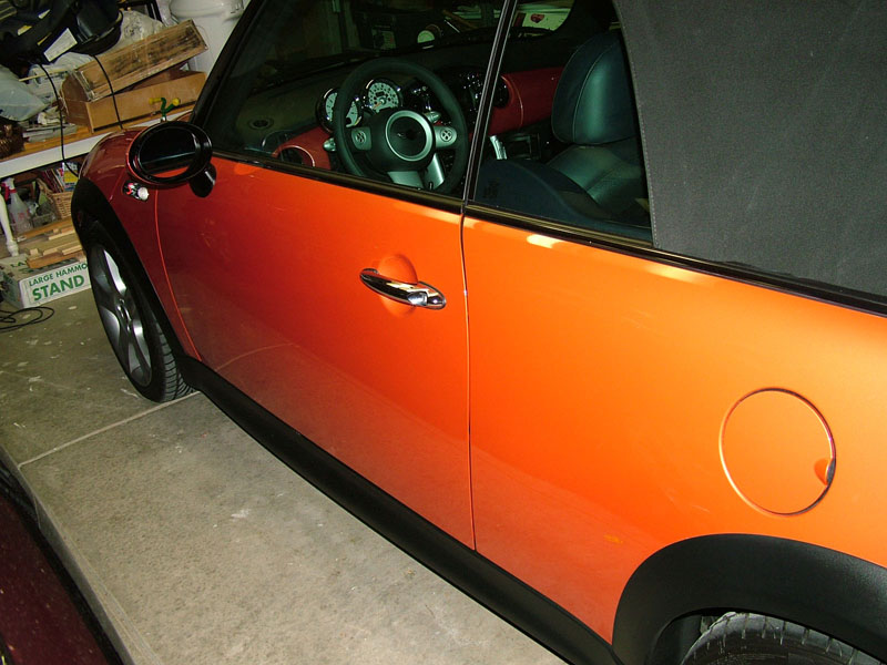

OK I read some other threads and I think I know what I did wrong but here's what I did:
1) Wash with dishsoap
2) Claybar
3) Wash with Z7
4) Z5 with ZFX
5) Z6
6) Z5 with ZFX
7) Z6
8) Z5 with ZFX
9) Z8
So now the surface is silky smooth. The shine is good but it's not as glossy as I hoped it would be. I'm comparing the shine of my Mini compared to the pics on the zaino website. After reading some threads I think I should have applied Z2 as well. Is this right or am I expecting too much? Anyway, next time I'll do 3 coats of Z2 with Z6 in between the first 2 coats and finish off with Z8. Hope that works. Any suggestions?

I thought the use of ZFX was so that you didn't have to wait as long before applying coats? FYI: I waited about 20 mins between coats. I did read about going back and forth between Z2 and Z5 but unfortunately I didn't do that. I'm planning on doing 3 coats of of Z2 next weekend. As far as I know this is ok. I'm attaching some pics of the Mini. Unfortunately, they're taken inside the garage at night with the overhead garage lights on (fluorescent lights) From the pictures you'll see that it's clean but it doesn't have that glossy/wet look. Suggestions anyone?
Attached Thumbnails Zaino worked "ok" Did I do something wrong?-dscf2725.jpg   Zaino worked "ok" Did I do something wrong?-dscf2726.jpg   Zaino worked "ok" Did I do something wrong?-dscf2727.jpg

Apply two coats of Z2 the same way you applied Z5 and you should see a better shine.
Old May 2, 2005 | 04:21 AM
Tarzan's Avatar
Tarzan
Joined: Jan 2005
Posts: 798
From: Charlotte, NC
Alternating Z2 & Z5
I am told that you "CAN" alternate between Z5 and Z2-Pro...not that you necessarily "SHOULD" do so for better results...just that there's no adverse effect to doing so.
Z5 will shine less, but hide more swirls and scratches.
Z2 will cover less, but will shine more.
Your original sequence is fine, ending with 2 or 3 applications of Z2-Pro, wiped down with Z6 between. At the very end of the process, you can use Z8.
You are correct that all the ZFX does is allow you to layer coats in less time (all in one day). If you stretch the process out over several days, you can delete the FX. But who would want to do that??? <G>
Also, if cost is no option, you CAN use Z8 as a Z6 substitute, or use Z6 all the time, and Z8 only on those special occasions. I find myself grabbing for the Z8.
You've done a very nice job! You can Zaino the beltline rubber/chrome strip, the side mirror plastic parts, and all the glass as well.
I use the Zaino tire gloss on the spats (wheel arches) trim, and tires.
