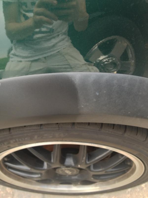

That's what I used in this pic. First time the trim had ever had special attention given to it, and I'm impressed. The trim looks like new from the factory after the whole car has been done.

I used that turtle wax junk.
Sorry guys, but have fun re applying every week.
