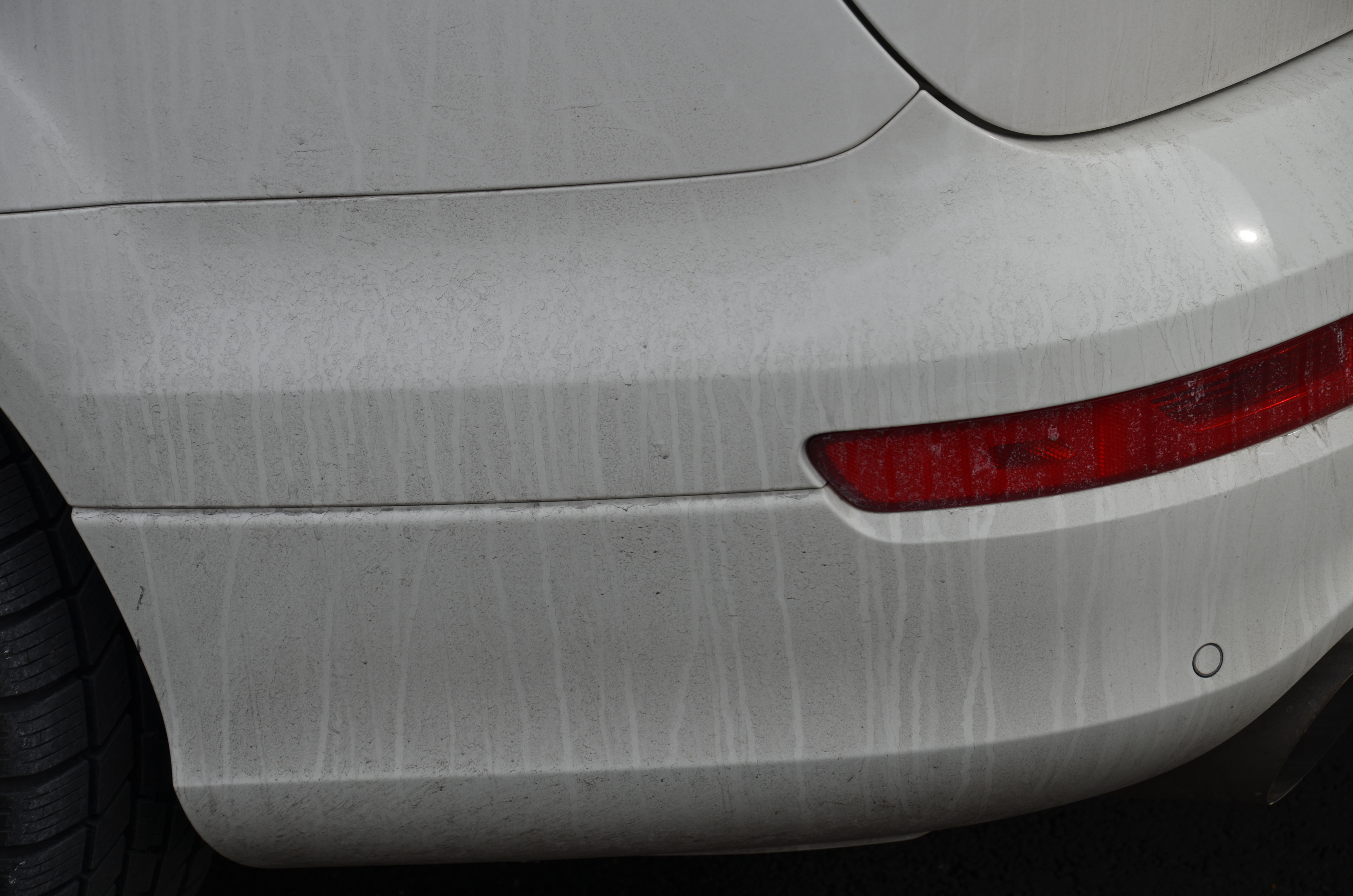

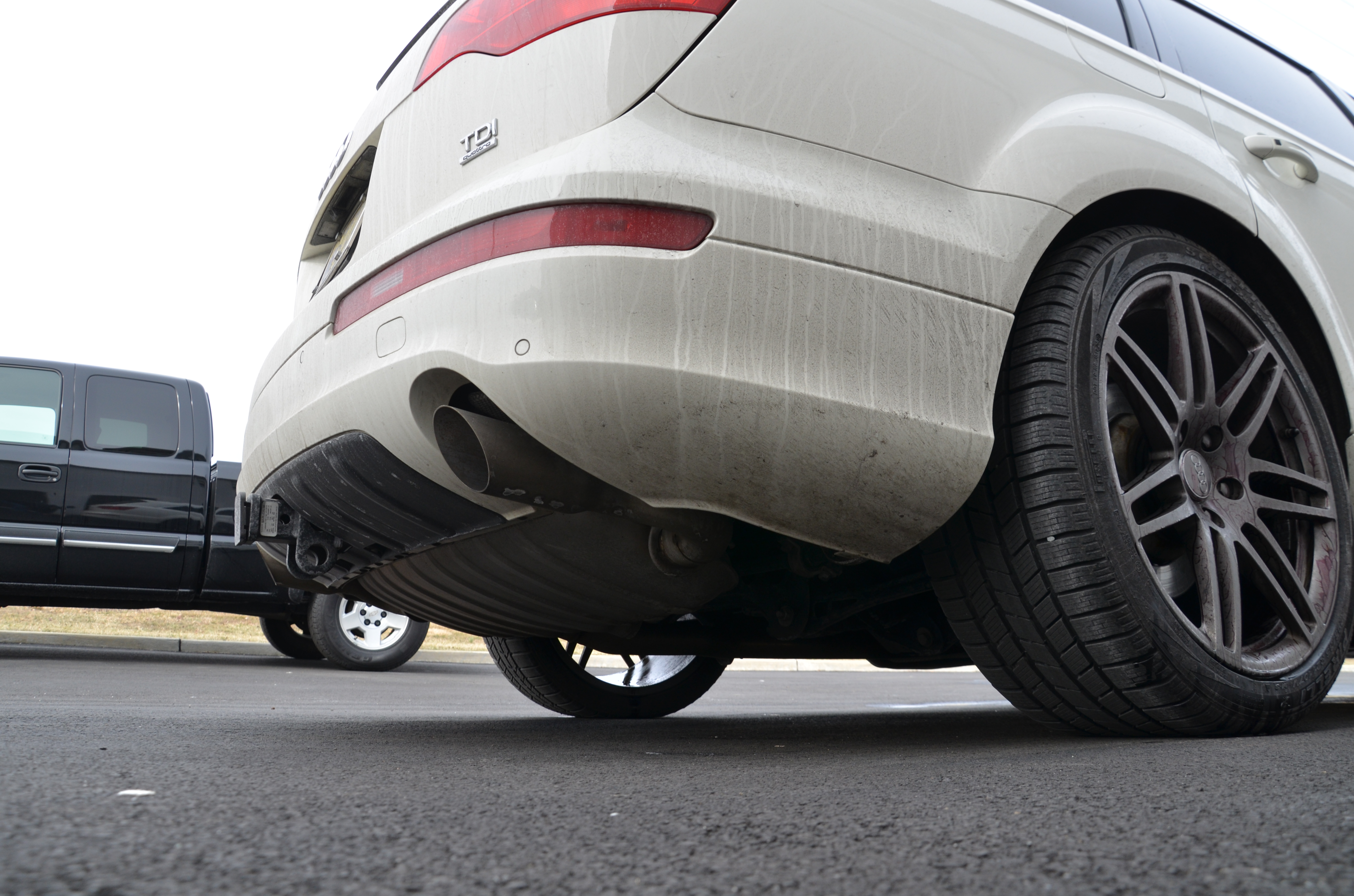

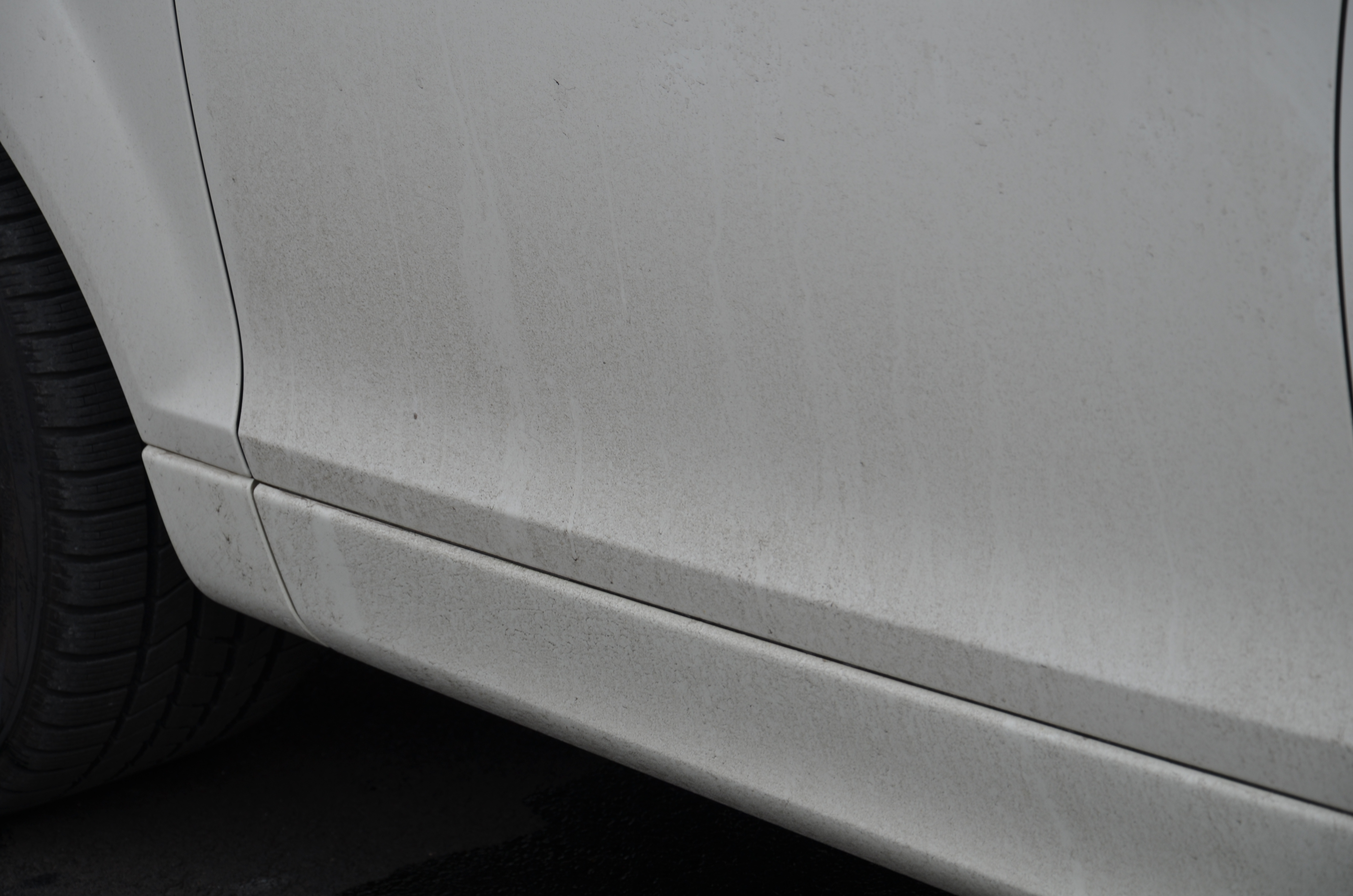

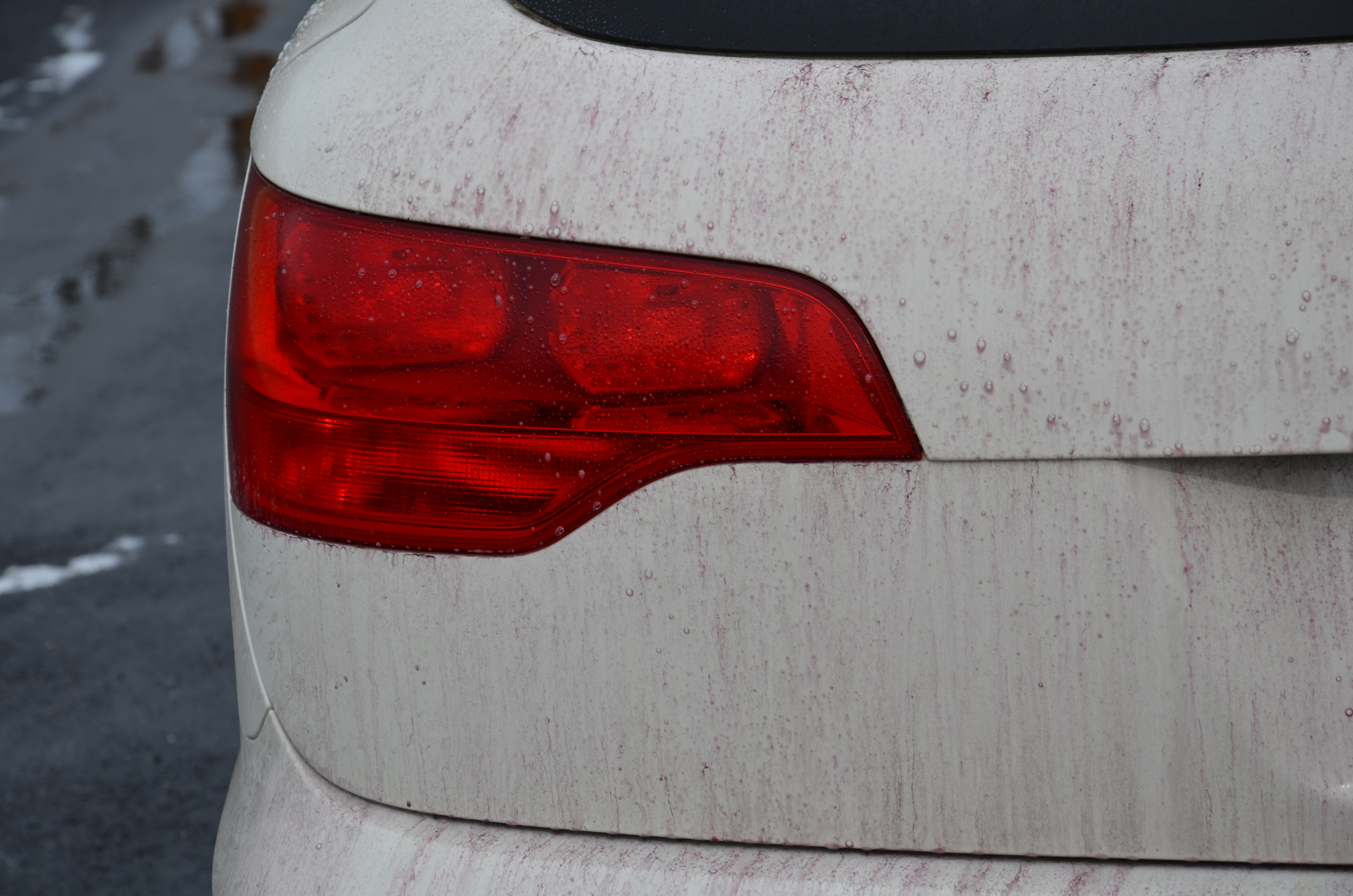

Before shots
A lot of salt build up.

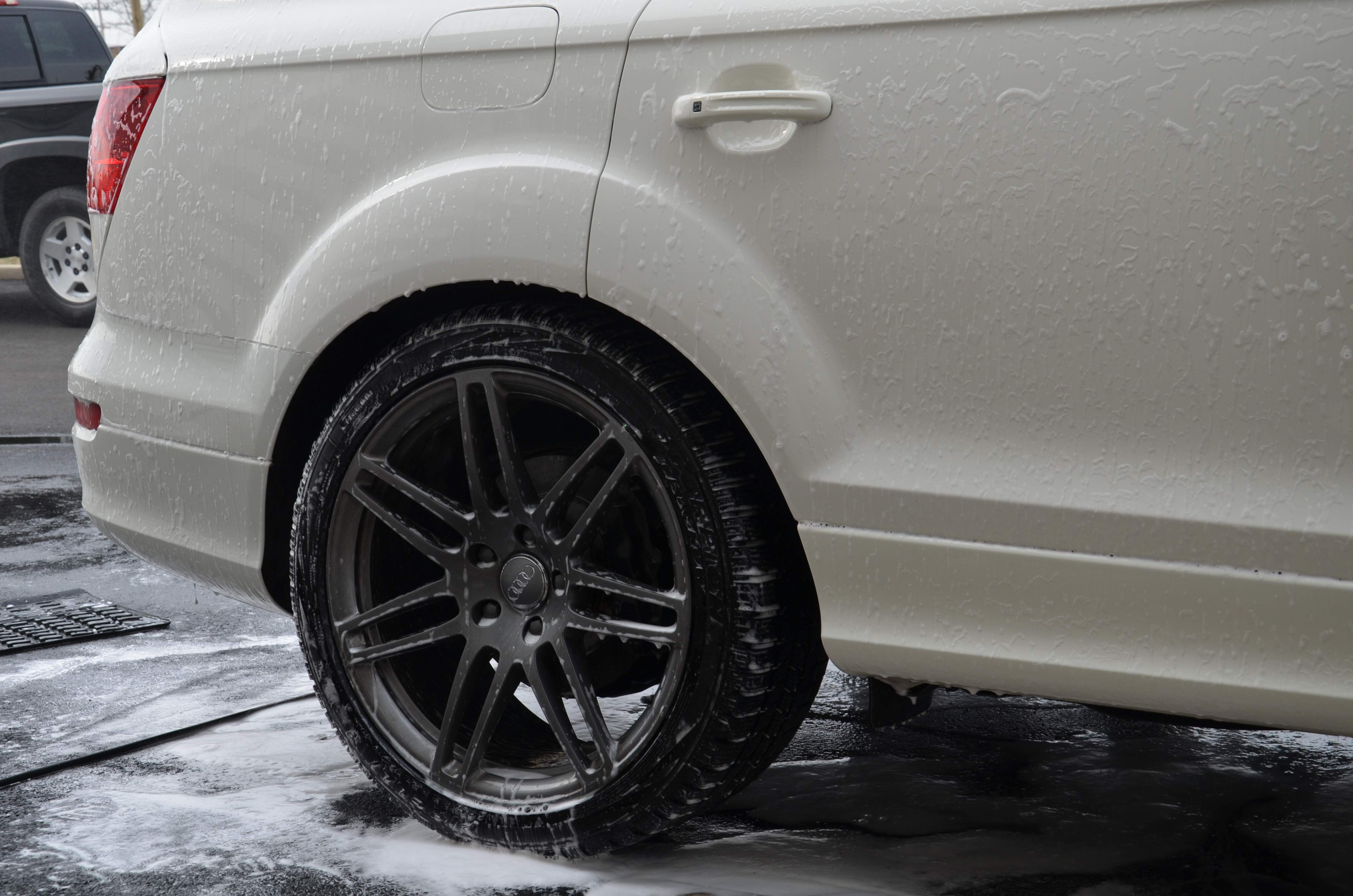

Wash - Wheels - Tires - Wheel Wells -Decon - Pre Soak - Wash - Autoscrub - Polish - Seal
Sonax Full Effect Wheel Cleaner
Wolf's Decon Gel working well, nice long dwell times
We have found that Adam's Car Wash and Adam's APC solution works well to help cut salt and grime off the paint in colder temps (ratio for the foam cannon - 2-3 oz of Adam's Car Wash 2-3 oz of Adam's APC - fill the rest with water)

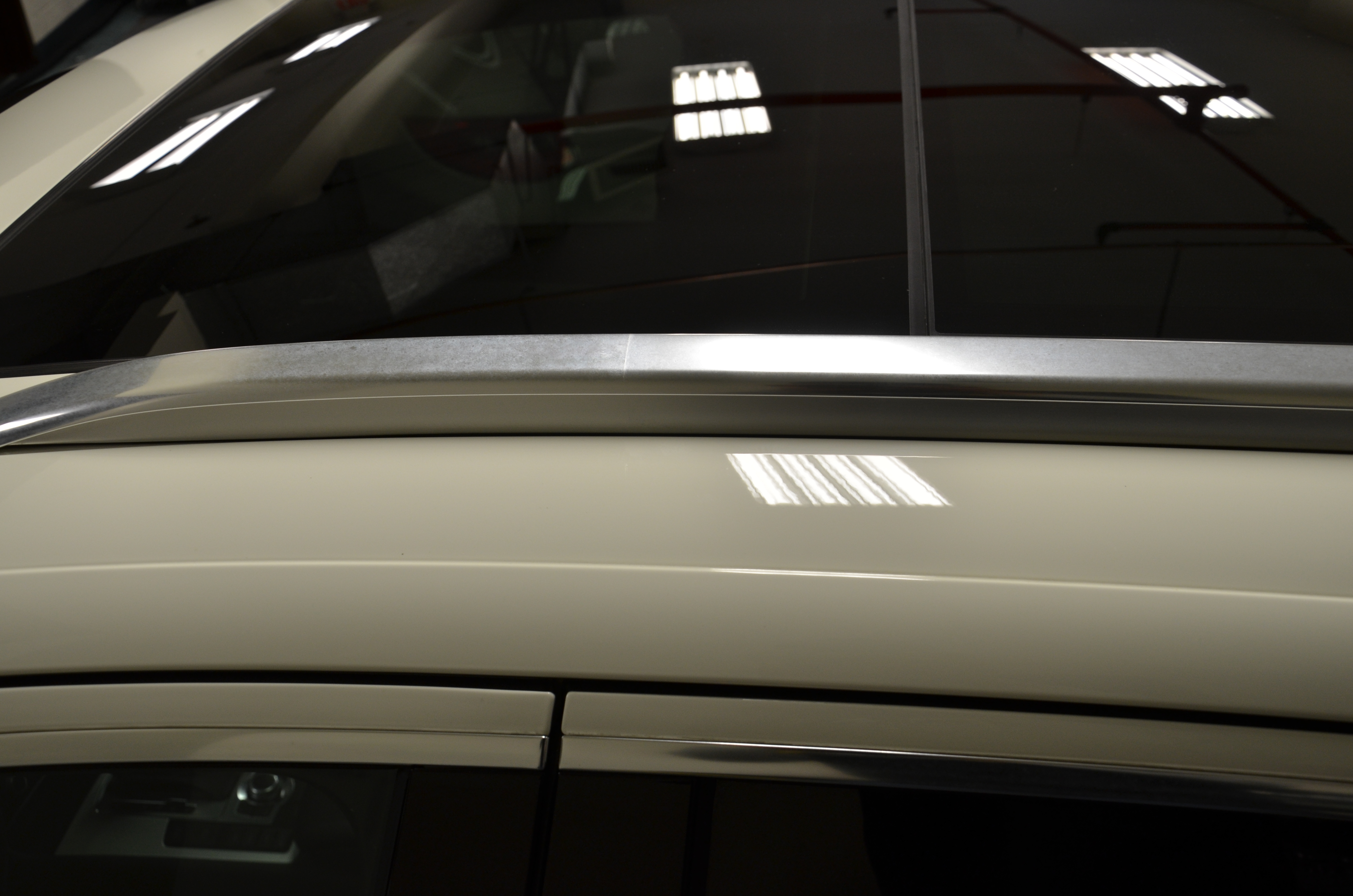

Cleaning up the Aluminum Roof Rails on Audis can be a pain but we were able to improve them using Adam's Metal Polish 1 and 2
Close up

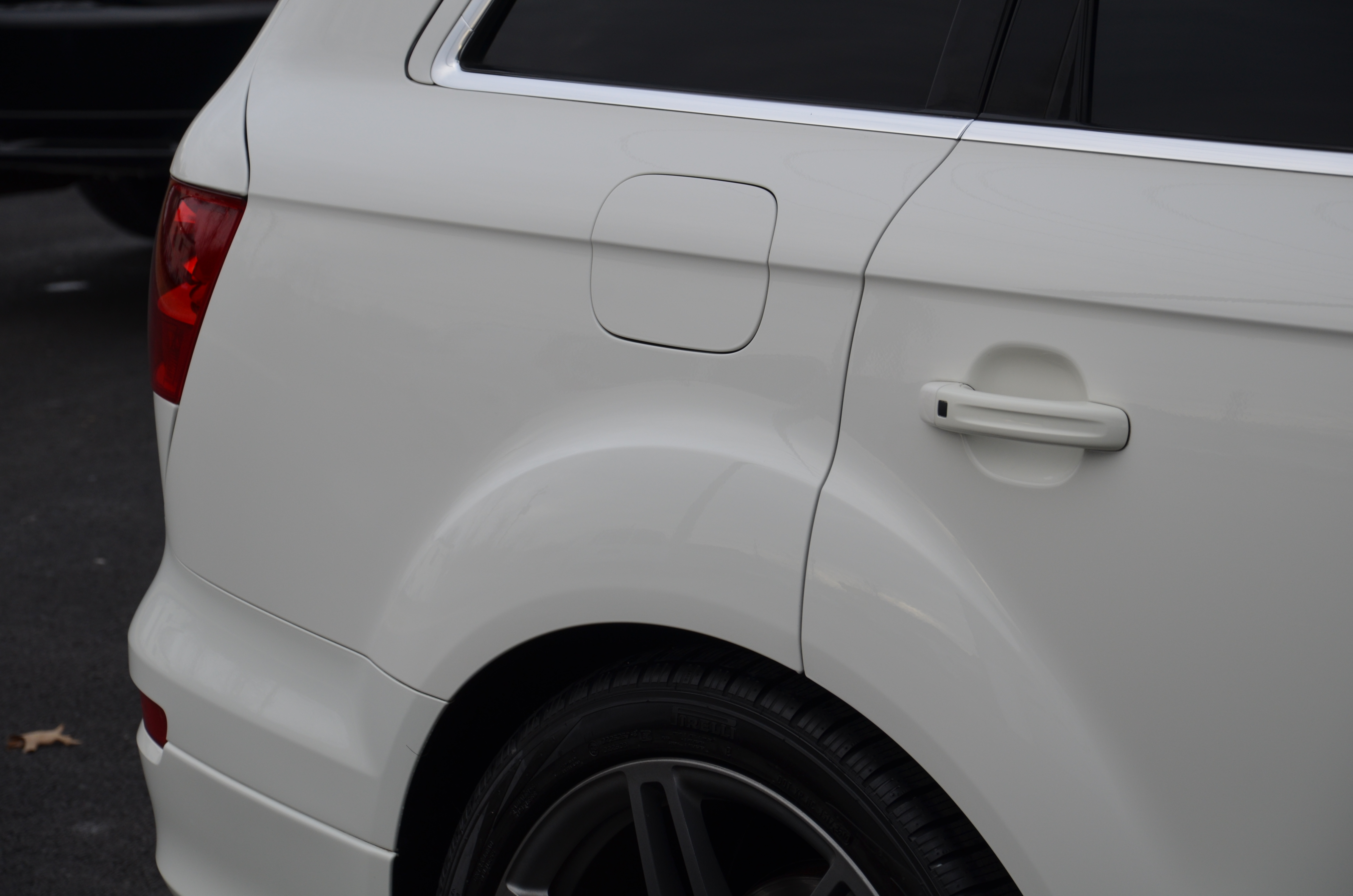

We did a one step polish to improve the gloss on the car using the Rupes BigFoot LHR21ES an Uber Green Pad and Sonax Fine Abrasive Polish
(sorry no photos)

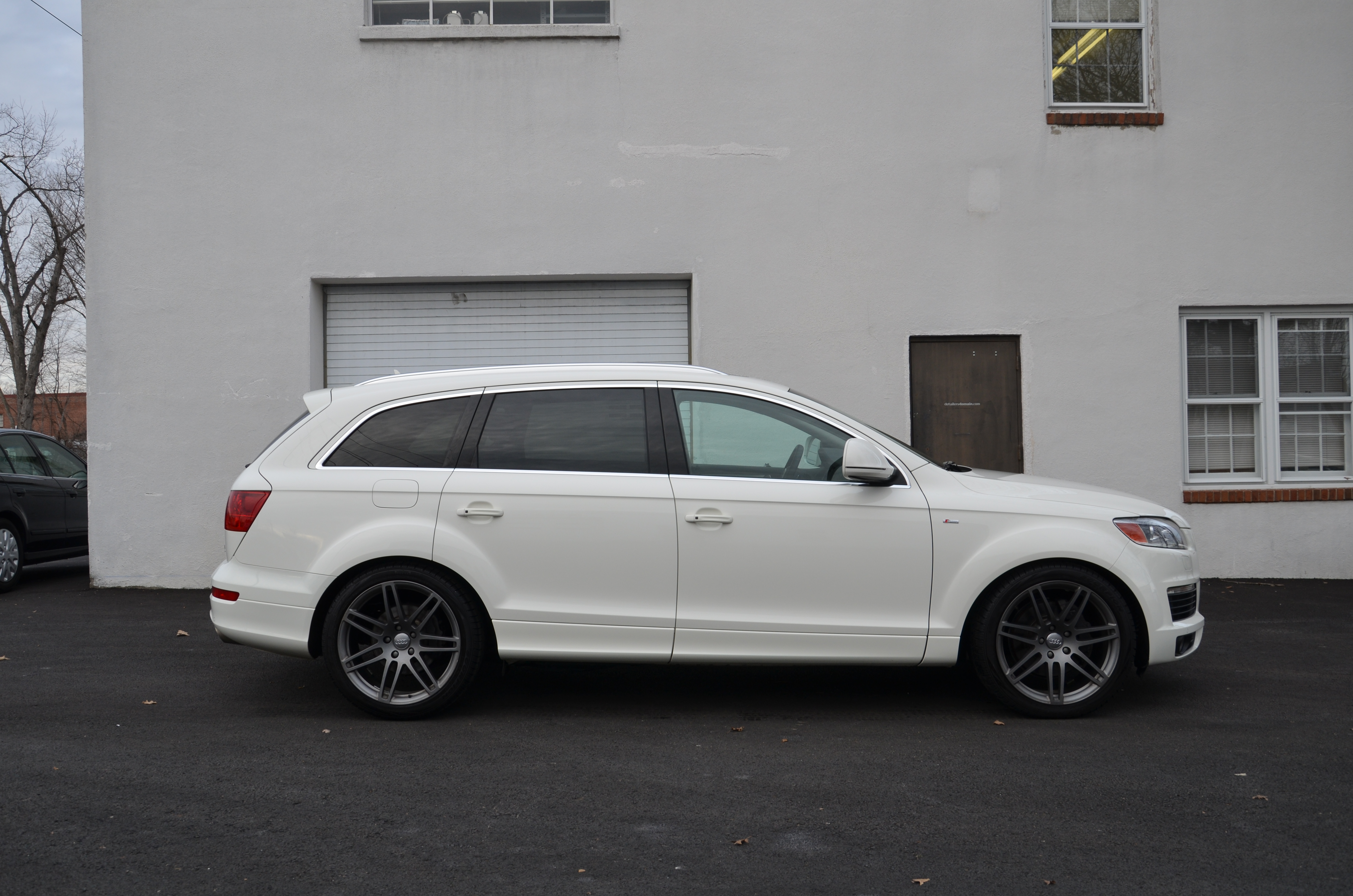

Afters

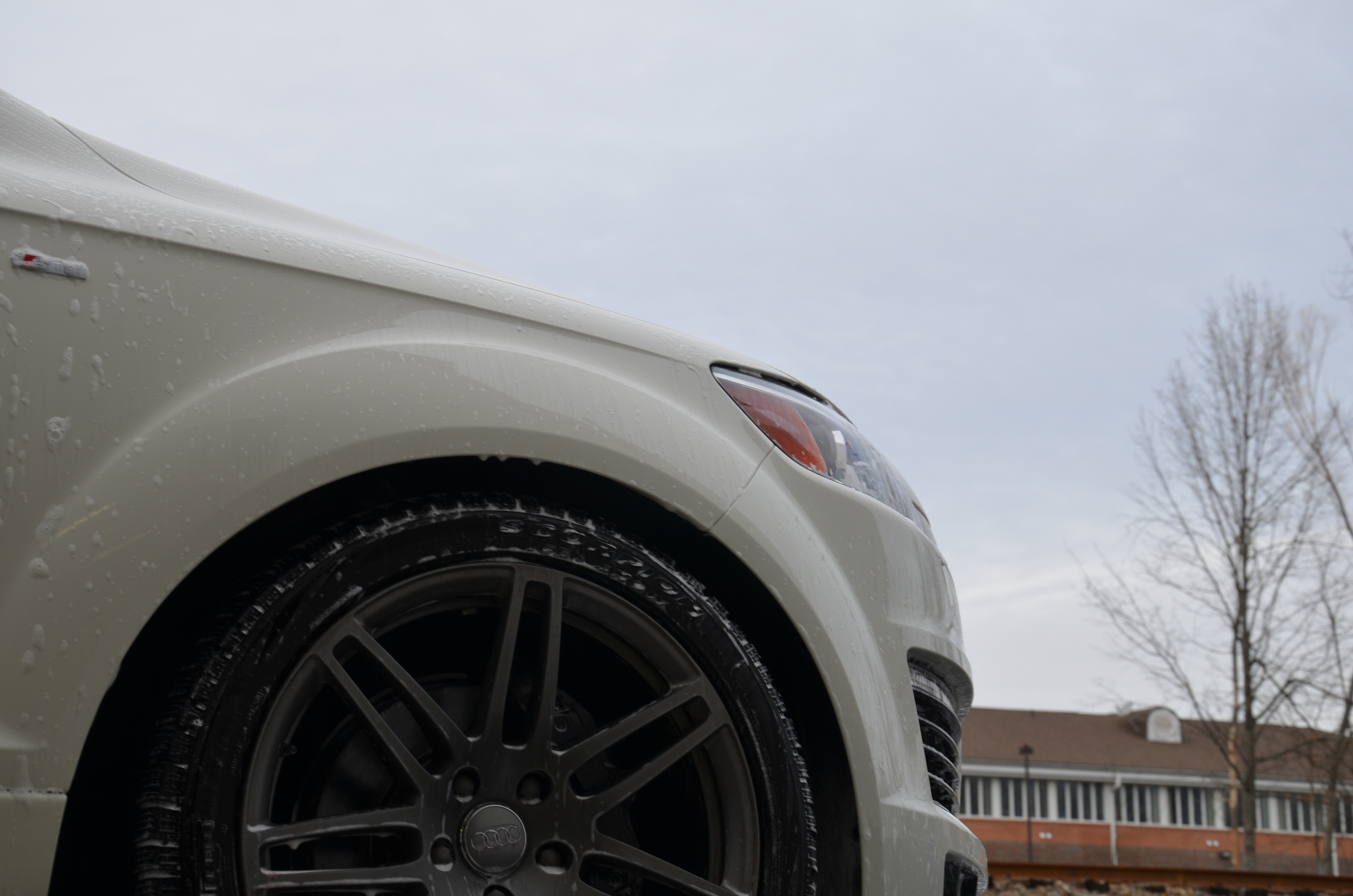

Beading shots of Sonax Polymer Net Shield after the blizzard
Extremely tight beading

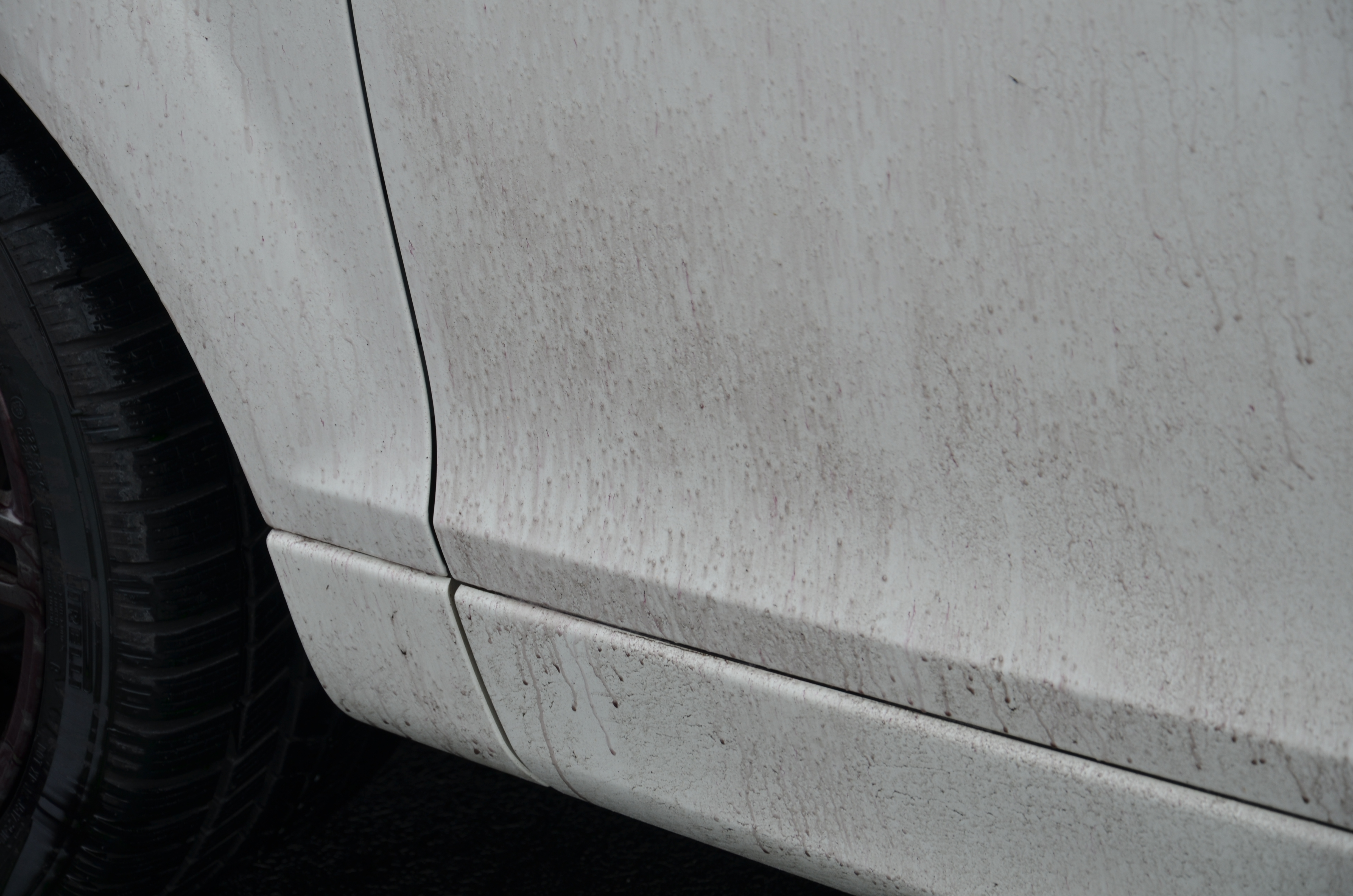

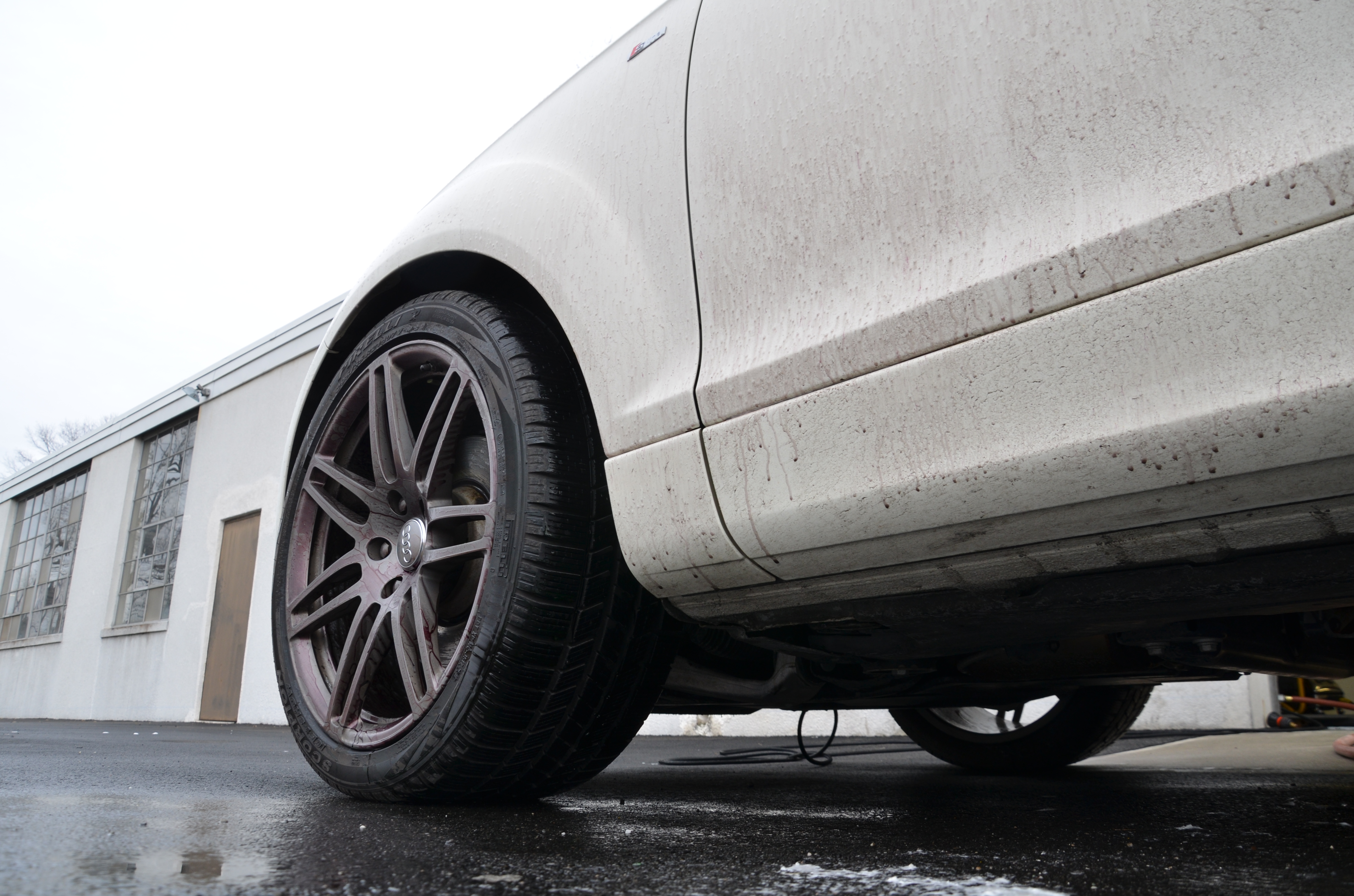

Before shots
Close up
(sorry no photos)

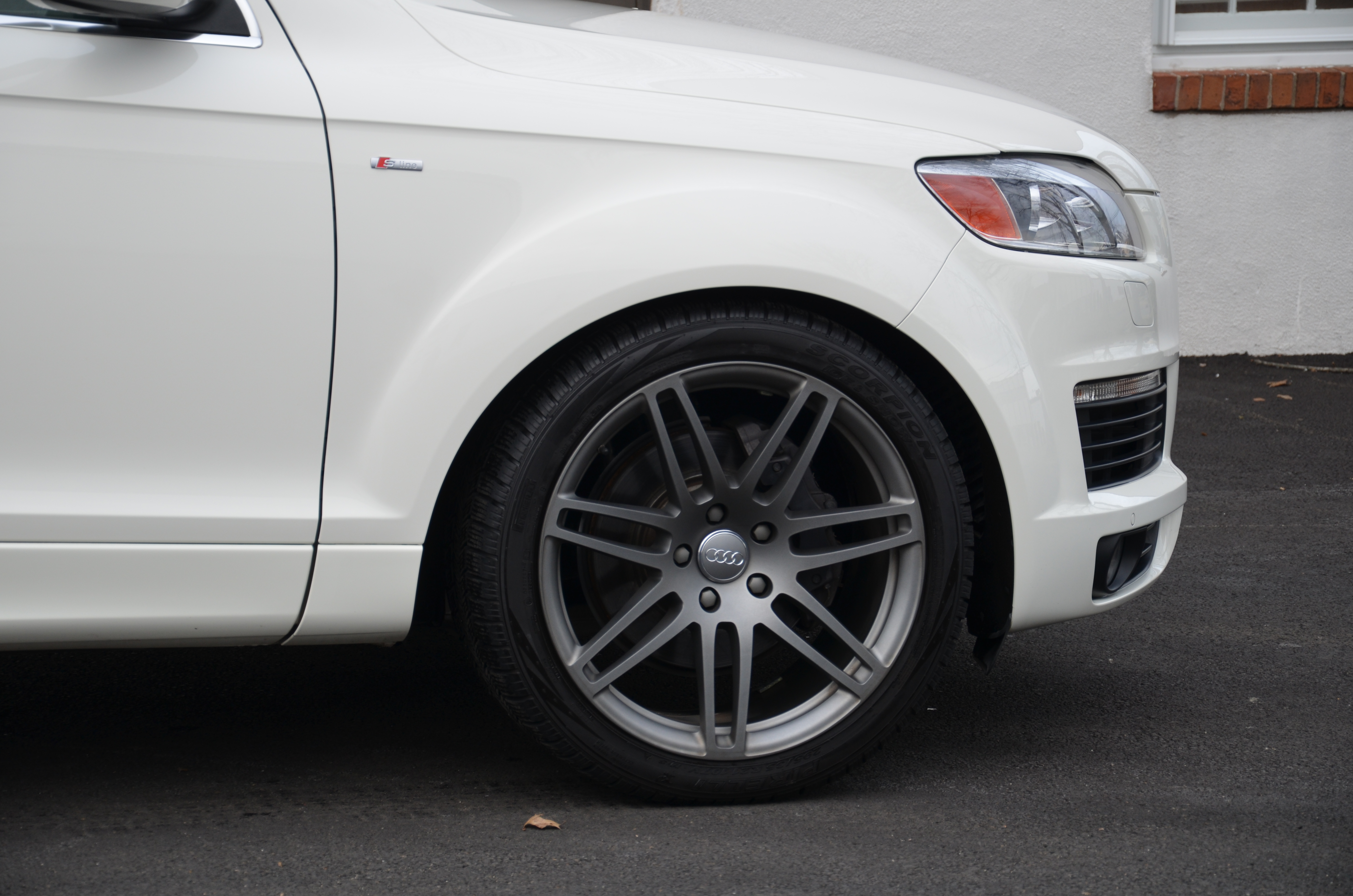

Afters
