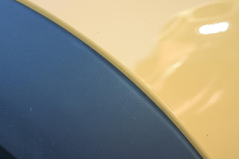

Here's a picture with a few of the spots in it. Yes, my wash was not thorough... it was a quick was because it was the first nice afternoon around here.

I see the spots---and the Swirls!!!!! lol. Yeah claybar should get it right off.

it looks like it is overspray for sure. i'd just clay it out and maybe put on a carnuba wax to hide those swirls from the prying eyes of this forum.
