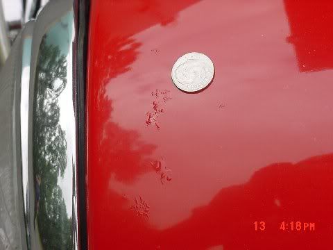

OK, so me being me, I'm already thinking about detailing a car I don't even own yet. Yes, it's a sickness.
I just put a deposit down on a classic Mini (a re-VINned '93 Mini Sprite titled as a '76 Leyland), color: red. I
I'm going to get it next week, and I'm knowing that I'll want to clay it really well and then run the PC over it to really try and make that baby shine.
One major issue that I KNOW I'm going to have issues with is the fact thatthere are two spots where the paint is damaged from beneath, one on the front wing near the LH headlamp and a second, smaller spot on the door panel:
I'm going to try and extend the life of the panel by sanding and re-sealing it from the backside, and replace it in a year or two - I don't want to hassle with matching the paint right away.
I'm assuming that I should NOT hit this spot with any sort of mechanical polisher, lest I crack or even strip away the fragile paint, correct?
It also looks like it has some dings and chips in the usual areas... I'm not sure about using a touch-up system since I have no idea what color this truly is (I'm assuming it's a repaint, but even the seller's not totally sure - if it is they did a great job and did the entire interior at the same time). I'll try to minimize their appearance with the PC if I can and maybe try out some touchup paints on areas like inside the sills to try and find a good color match.
Can a paint and body shop put a sensor on the car and read the color, then match it to the closest commercially-available color, in order to get the right touch-up color? I was going to try that system that people have been talking about that spreads on like a wax as opposed to actual touch-up paint.

damn, the deposit was only a dime??!

honestly, i would get the car repainted. that looks like rust from the
inside. unless you live in a super dry climate like socal, i think it's
going to eventually spread like cancer.

It will - I know it. But I don't have the budget for the replacement parts and the repaint right now. Maybe next year. I'm checking to see if re-sealing the back-side of the panels will help extend their life - I figure I can pull them off when I garage the car for the winter and see what can be done. heck - I might just do that everywhere, depending on how difficult that would be - might as well head the corrosion off at the pass, right?
In the meantime, I'll just get it looking as good as I can.

yah, if you see any open corrosion from the back side i'd
recommend sealing it with Rustoleum until you get a chance to
take her in.

Hi Matt, Nick here. Heather asked me to take a look at this thread for you. As you surmised, it is rust. You do not want to hit it with a polisher or the paint will flake off. If you are able to re-seal it from the backside you are in a world of rust because that would mean that it would be through the metal. Hopefully it is surface and only under the paint.
You really don't want to leave the rust there. Rust is way worse than mis-matched paint. CHKMINI should be able to get really close (if not exact) with the color. Perhaps he can load the paint into a rattle can for you. Carve out the rusted section, sand it, tape and plastic wrap the rest of the car and spray.
As painful as it may seem to pluck off the color from above the rust, it must be done. If you leave it for two years, you may be forced to weld in new sections as the rust would have eaten through the panel.
I hope that helps. Good luck!

Ouchies... I just don't know if that level of body restoration is within my skill range. It actually might be easier to replace the entire wing in a year or two than to carve out a section and replace it smoothly enough that the perimeter of the repair will not show. I can probably scare up a few people that I know that can spot weld but that...? I'll have to ask around and see if anyone in my local community has those skills - I get the impresison talking to some of my local restorers that they generally just "do the job right" and pluck off the entire offending panel.
I guess I can check it from the inside when I see it and see how bad it is in there - I hear that kind of damage is fairly common.

Matt, I think what Nick was trying to say is that you will need to remove all the rust from the surface of the fender under the paint. I doubt you would need to cut out a piece of the fender. I would first use a Dremmel to remove a square section of paint to expose the rust and find good metal. Then you can either grind out the rust down to bare metal or use Naval Jelly to convert it. Then sand the area smooth, Bondo to flush and sand again. Primer and paint. All this can be fairly localized and is a lot less difficult than it sounds.

OK, now THAT I know I can do. I'll check to see if the corrosion really is just under the paint, or if it's literally from the backside. If it's from the backside I already know the best I can do is coat it with something like Waxyol and try to delay the day when I have to replace the entire panel. If it's just a surface spot then I can do a simple Bondo job if I can find someone with the Mad Painting Skillz to cover the repair...

Actually Naval Jelly is nothing more then Phosphoric acid. When applied to rust (iron oxide) converts it to iron phosphate which is water soluble. It may take a couple of treatments to get all the rust converted, but it is pretty effective.
