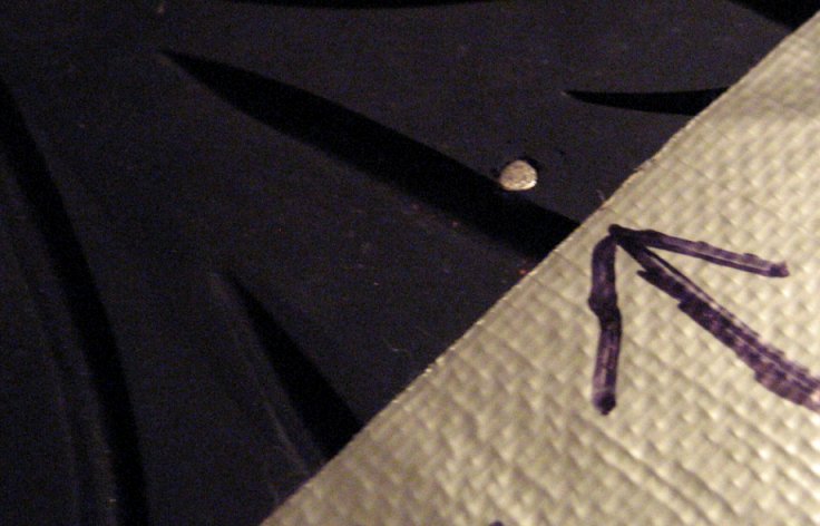

Oh no! I was inspecting my summer tires, planning to switch to them soon. I found a nail in one, right in the middle of the tread . Any suggestions on repair or replacement and where I can get this done?

Go to tire rack and find an authorized installer. They can fix it for you. Also, only accept the fix that puts a plug and patch inside the tire, it will last longer and is MUCH better.

I took the wheel over to the Merchants on 50, they were listed on the Tirerack site. They did an internal patch for $28. Not bad
Thanks for the advice

Much like normal tires it depends on where the puncture is. It has to be well in the tread. Also once a run-flat tire is patched the tire's integrity is compromised and it is no longer a run-flat tire.
