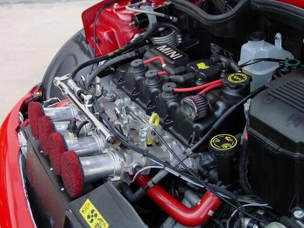

I've never had a throttle response issue on my Cooper - now, on the Cooper S's I have driven, ugh. The throttle response on the S sucks, IMHO.
The throttle response is better with the head work and new cam, though. Freer revving, overall.
The individual throttle body mod would be fun just to do it...
