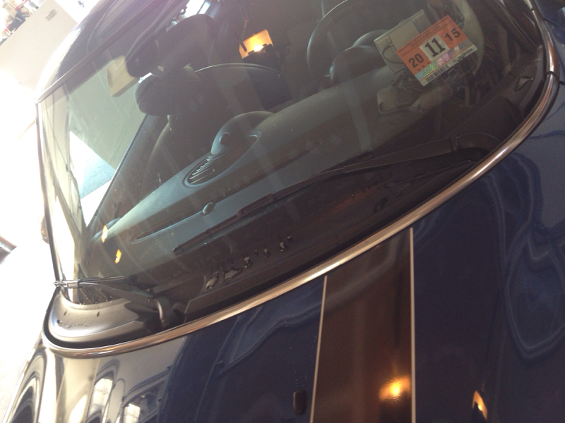

I installed the new conversion wiper blades and wiper arms that ECS sells that allow 2013 wipers to be installed on earlier R56s. They are great.

Very nice, looks great. Encase anyone is also looks for the conversion kit , its right here.
Aero Wiper Blade Conversion Kit Part # 61610039343KT

I have a 2010. What are the advantages of the 2013 wipers?

They area more even contact but it is more if an style thing. They are a simpler look.

pics? i went from an '08 mini to a '13 mini, don't really recall anything about the wipers

They are a simpler architecture. Look at the first post and you'll see the initial pics. The original blade are conventional in design where these are spring steel.

Yes pics are right above in the thread.
