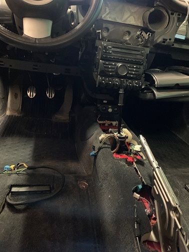

New Pedals
and the newish 6 Speed shiftier
Updates on my Conversion
Old Jun 25, 2019 | 07:32 AM
  #136
nolimit's Avatar
nolimit
Joined: Oct 2002
Posts: 476
From: Fairbanks,Alaska
Cleaned up the engine bay and touched up some of the paint.
The engine is all ready to go.
One of the biggest surprises I had was how badly damaged the Radiator support had, 5 different breaks and a big chunk missing on the bottom.
This Friday the ECUs should be in from Way Motor Works, KUDOS to a very quick turn around.
If all the last misc parts get here and all goes well Francis should be derivable by the end of the weekend.
I'm also using this as an opportunity to replace the coolant hoses, they are almost 15 yrs old, and other minor things.
