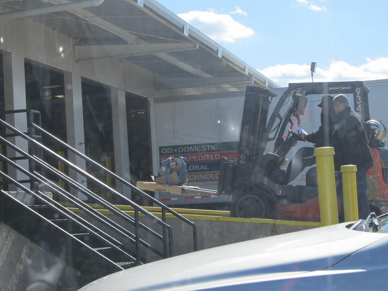

Also, everything worked out with selling the old tranny to shop in Cumming, GA. Got $500 for it! They even covered the shipping through Old Dominion.
It was a strange and satisfying feeling driving the old tranny to the drop off location in the now 6-speed MINI. Attached are a few pictures, including my thankful last view of that CVT!
