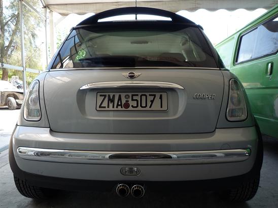

Ηere is mine with Supersprint center exhaust and BMP/Promini exhaust tips.
Attached Thumbnails Need advice - exhaust for R50 that has the Cooper S twin tip-p1000012_1.jpg
