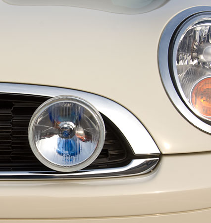

Yes, the JCW version is what you need for the MC.

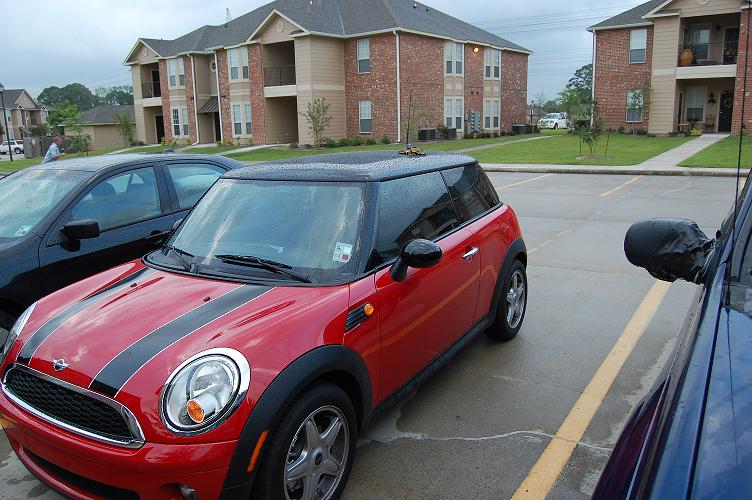

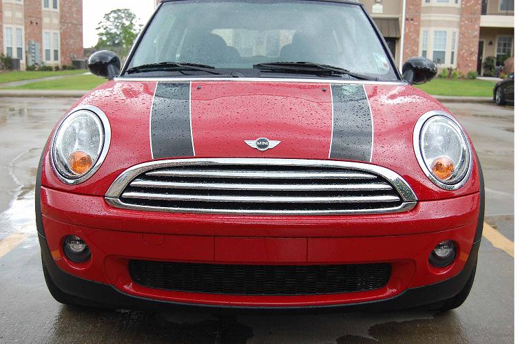

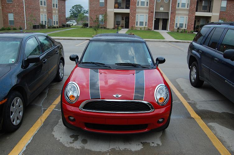

I got mine from outmotoring.com Here. Did not get the upper and lower trim pieces as I would probably get them vinyl wrapped. In a way I wished I would have gotten them all together and just went with the all black look. I blacked out the beltline the same day I replaced the grille.
Attached Thumbnails Help please - front grill-front_orig.jpg   Help please - front grill-grill2.jpg   Help please - front grill-new-grill_beltline-blackout.jpg
