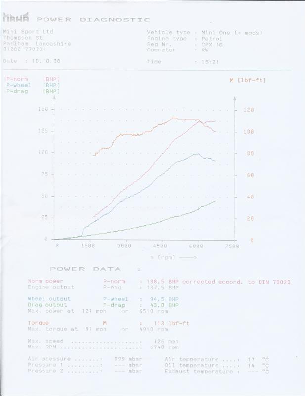

Had my Mini One at Minisport at the weekend. The exhaust was blowing badly at the pre-cat flange and there was no mechanic there to fix it.
Anyway it dyno'd at:
138.5 bhp @ 6510rpm
113 lb-ft @ 4910rpm
Mods (by me) are: Janspeed/GTT Manifold, Miltek catback, Pipercross Viper CAI, Pipercams road cam, Minipowerprog remap
Attached Thumbnails MINI Cooper non-S and MINI One dyno sheets-morethanaone-custom-.jpg
Last edited by scraggles; Oct 14, 2008 at 02:14 AM. Reason: added scan of dyno plot

Not too shabby. Once a head is added it wont be far from the mystical 150
