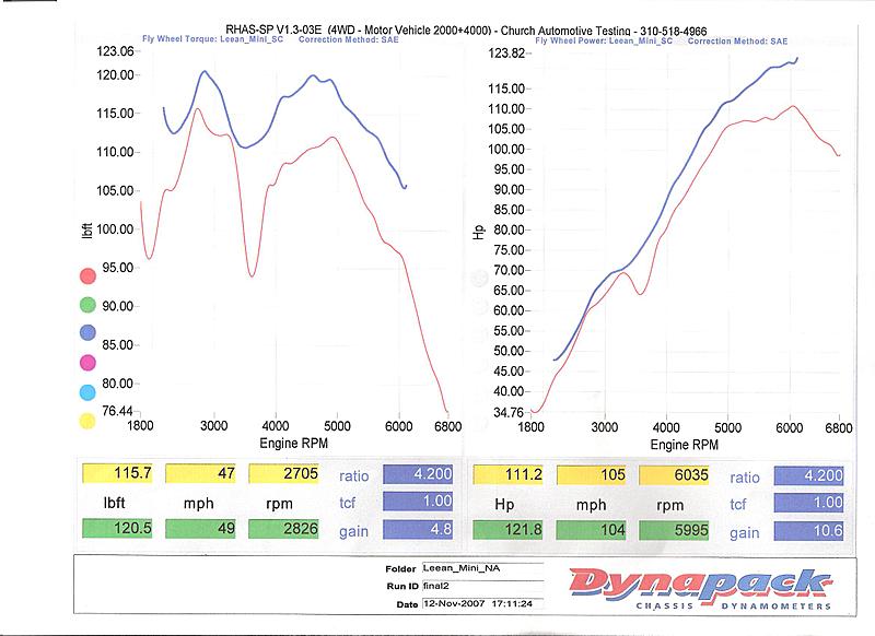

Also, the perfect example of those tuners I was talking about, is MTH.
There are several dyno sheets that I added from people who had MTH software.
MTH claims 130hp.
But nobody was able to dyno higher than 122hp.
Perfect example.
Here's the screenshot of that pdf file that I posted:

Mini Cooper:
Max HP: 111.26 HP (wheels)
Max Torque: 105.32 Ft/Lbs (wheels)
K&N Drop in, Minspeed cat-back, Screamin Demon Coil, Nology Cool Wires

Let's see, 111 hp at the wheels = about 127 hp at the flywheel (15% loss) or 133hp at the flywheel with a 20 % loss.
That's at least a 10-15hp gain over stock, with just a panel filter and cat-back exhaust.
Possible ?
Decide for yourself.
A panel filter is good for about 1-2hp at the flywheel.
A cat-back exhaust might give you 1-2hp in the best circumstances.
Your other mods don't give extra power to the car.
People with the same mods, but better products (meaning custom exhausts and open intakes with heatshields) have produced about 10hp less than you.
People with the same mods as you, but also with software and headers, have been known to produce 1hp more than you or even 2hp less.
Decide for yourself which result is more realistic.
You produce 105 ft/lbs at the wheels which is about 142Nm at the wheels (these cars have between 145/150Nm stock at the flywheel), which would give you an extremely high torque result at the flywheel for a car with your mods.
Did you dyno with the hood open ?
Yes, I was amazed too! We did dyno with the hood open, but I don't see how that would make a difference on non-super or non-turbo car. Every car starts off with a different number. I'm not sure, but maybe I started off higher then most people. I was very pleased with the results.
-Addison
Dyno with the hood closed next time and then you'll get the real numbers
For our cars it matters just as much as for a turbo or supercharged car, trust me.
Hot air is a performance killer, maybe even more for a small NA engine like ours.
Since you did a dyno run with the hood open, I wouldn't be surprised that you produced at least 5-10hp more compared to what you would have run.
Look at the dyno sheets of that Cooper S that I showed above.
The increase isn't going to be equal for a non S, but you get the picture that there is an enormous and unrealistic gain that can be made.

Here's a result from Revolution Motor Works custom tuning (Dimsport software). From post #183 in this thread.

That dyno shows a realistic result.
A stock Cooper that went from 111.2hp (flywheel) to 121.8hp (flywheel) with just software is very believable.
I assume this is flywheel power like it says on the dyno sheet and because if these are wheel hp numbers, it would not be possible.
This is a result that I have seen before.
A guy I know went from 111.1hp to 122hp with software and open intake (no heatshield).
