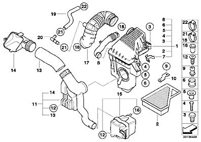

To make the stock box a little louder couldn't we just remove the resonator?
Part 15
has any one tried that?
Old Nov 1, 2007 | 11:34 AM
R50 Paul's Avatar
R50 Paul
Joined: Oct 2005
Posts: 302
From: Covina,CA
I've been wanting to give that a try.....

Whoever has the MiniMania airbox/filter has had to remove the resonator. Supposedly, it can be quite difficult to remove.
Old Nov 1, 2007 | 03:31 PM
cristo's Avatar
cristo
Alliance Member
Joined: Apr 2003
Posts: 4,101
Likes: 229
From: York, Pennsylvania
I have one. It did take some serious tugging to pull out the resonator.
