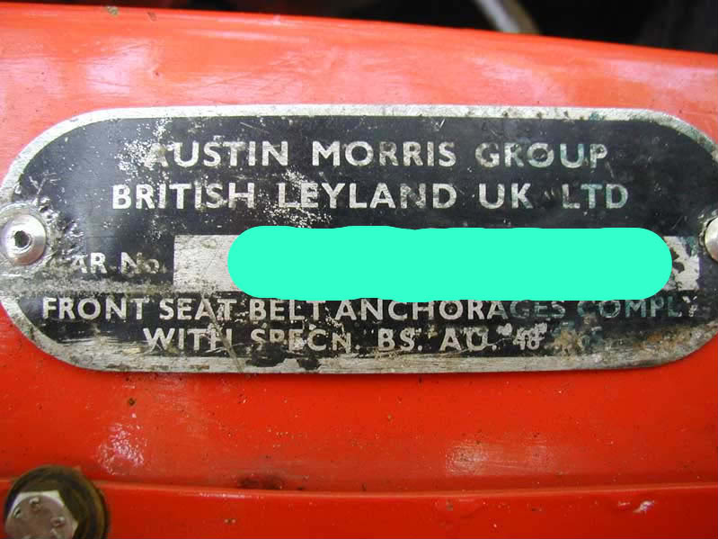

on my 79 ... a KNOWN 79 as I have the original papers and the "secret marks" match ... it is stamped from behind resulting in raised letters/numbers. Mine has been relocated since my front clip is now glass ...

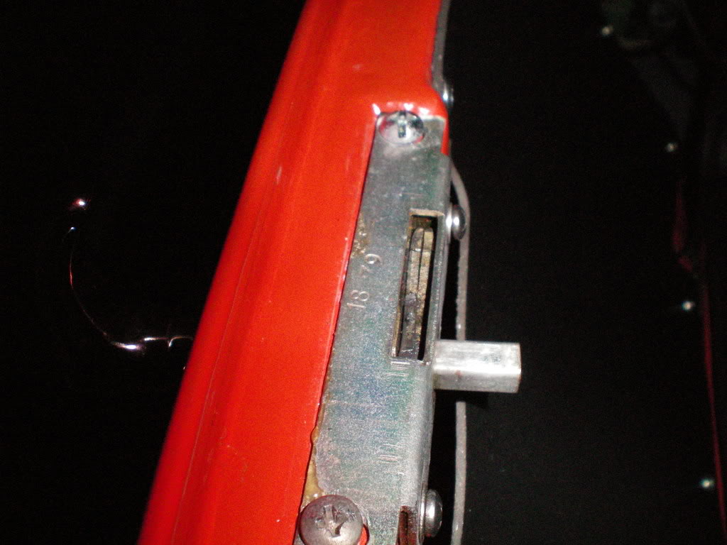

btw OP .... an easy way to check the year ... the week - year of production of certain parts is stamped on. The easiest one to check is usually the boot latch. On the top, you'll find a set of numbers. Two digit week, two digit year. This part is seldom replaced .... highly probable this is original
A similar stamp appears on the wiper motor, but IME you need to release the motor and move it around to find the number.
A similar number also appears on the Dizzy [distributor] but these are more frequently replaced . . .

Here is a pic it is not stamped or embossed it is literally done with an engraving pen! And illegible
