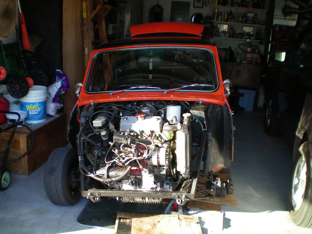

I thought I'd make a thread on my classic. She's a 1982 w/ a 1275 motor. Interior wise, everything is factory. I bought her while stationed in the UK and finally she's arrived.
Here is she when I picked her up at Galveston, TX:
