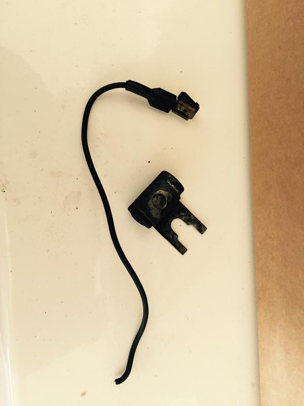

See attached. It broke. It looks like it's just a ground, could I make my own or do I have this particular part?

where was it? Looks like a simple condenser folks hook up to try and reduce static the radio picks up. There was a similar thread not too long ago. If that's what it is ... it is meaningless/un-needed.
http://shop.advanceautoparts.com/p/b...g84p/5260744-P
good writeup about the problem trying to be solved: http://www.oldcarsweekly.com/news/ho...o_interference
Only place I know a condenser like this is required is in the dizzy.
http://www.7ent.com/products/condensor-25d-dcb101.html
this item is replaced at the same time as the points under routine maintenance (until you go Pertronix and save yourself the trouble)
I'm guessing yours is NOT from inside the dizzy.
Can't speak from experience about how well the radio gizmos work cuz altho I have a radio in my 79, I have no antenna! I occasionally play a CD but otherwise it is just for looks .... installed by previous owner; I listen to the engine sounds!

That wire is from the ignition coil and goes to a nut that holds the ignition coil. I think it's a ground wire.
