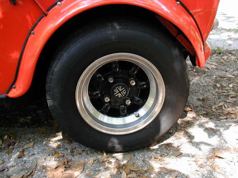

by the way this thread has helped CONFIRM to me that my wheels are not MiniLite despite what the previous owner claimed . . . . cuz my wheels do use 'domed' lugs and not the flat surface lugs of true MiniLite
if anyone CAN ID my wheels I'd be very happy . . . I think they might be GB's but there are no markings that confirm that. As I said, guy I bought it from, and broker in UK b4 that, claimed they were MiniLight but that is clearly not so.

And to Capt_bj: The wheel you have is not a Minilite which was the originator of that style, it could be a Minilight(different), 100+, ROH Contessa, or various replica of the Minilite. Of the many copies of the Minilite the one which is most like the original is the Minilife(note spelling)

Old Nov 8, 2013 | 04:27 PM
JBC4317's Avatar
JBC4317
iTrader: (9)
Joined: Jun 2010
Posts: 424
From: A Proud CA Lifetime Member on the FUN Site
Your wheels look like GB wheels
