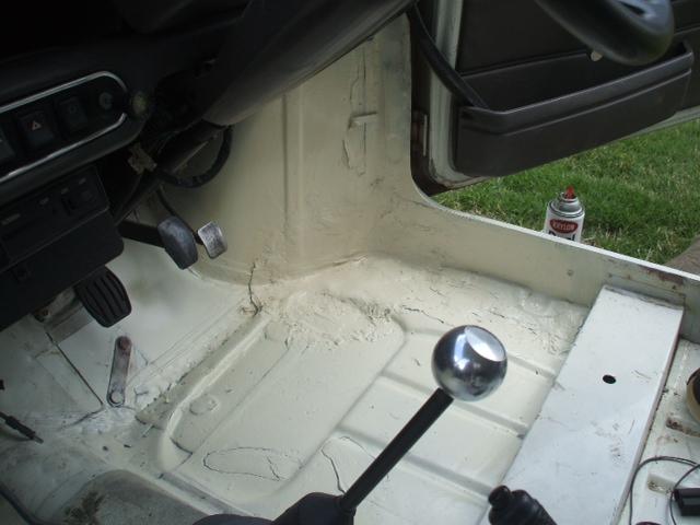

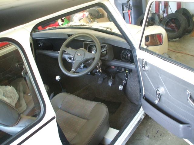

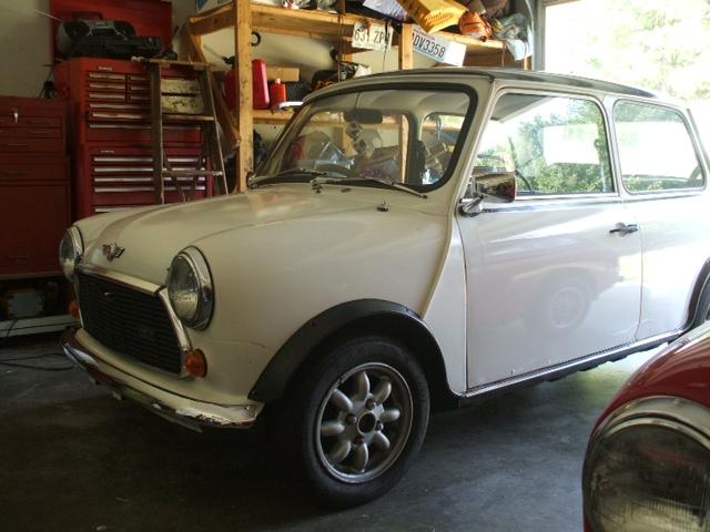

I've been looking around for a classic mini for the past few months and one has popped up for sale very close by to me. The seller is firm at $6000. The car runs and drives very well from the test drive I took( has a new head and disc front brakes) and the interior and exterior on a whole are in good shape. There is some rust on several of the usual spots. The front floor pans appear to have been patched, one well and one not as well. The rear subframe has some pretty serious rust with the metal starting to flake on one section. It also looks like the rear subframe mount in the trunk has been repaired at some point. The rest of the underbody is coated in Por15 so its hard to tell exactly whats going on but from the inside it appears mostly solid.
I have uploaded some additional and larger pictures of the car to http://www.flickr.com/photos/tarikatl/. From the pictures and the info above does this seem like a reasonable deal? I fully anticipate a good bit of work in the future but I am having a hard time finding a good baseline price for a mini in this shape from previous sales.

my opinion is that $6000 is the least someone should expect to pay for a car that will run reliably and be safe on the road - all the lights work, brakes are solid, car can reach hiway speeds (60) and drives reasonably well at that speed. Price goes up from there with better condition, rare model, modifications (up to a point)
Biggest concern I have from the pictures are the front floor pans. Fresh paint and undercoating hides a lot and as you say, you can see where part of a try was really poorly done. How are your welding skills? From experience I can tell you this repair can get very $$ very fast. After one time paying for some patchwork I found it cheaper to take welding and body repair and painting classes and buying the equipment!

The seller says it is a 68 but clearly it isn't. It looks like a MKIV to me. It has a 998cc and it pulled very well and ran smoothly when I drove it. It does leak a small amount of oil, but from what I've read that is to be expected.

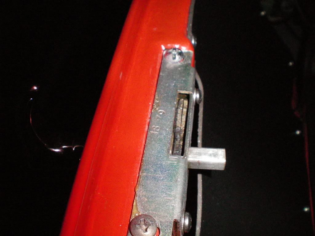

yep - clearly not a 68!
What size are the disk brakes? I'm guessing 8" and that's gonna point to an 80's car. Headrests, dash, steering wheel, tail lites, badges all say after 68.
The week and year of build is stamped into several parts on a Mini and if these parts have not been replaced clear up the question. Easist one to find is the boot lock plate. Here's my 79's
Similar can be found on the dizzy and the wiper motor.
