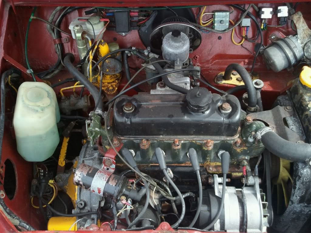

Here is the only picture I have of the set up currently:
I will open it up today and get more pictures and inspect these areas.

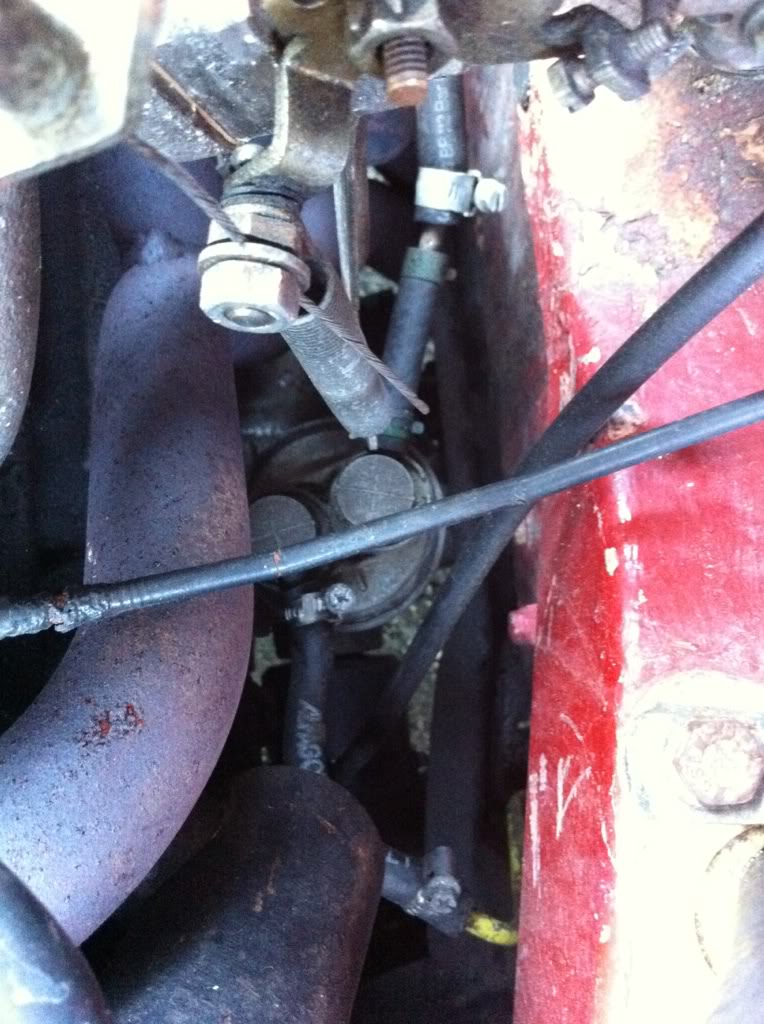

Yes mechanical pump, currently looks dry.

Thank you for all of the tips. I wish I could see some moisture on or around the pump.

have you run the motor and watched the pump? If the pump is leaking you should see it get wet pretty fast.
I doubt I even lost 'much' fuel, but it doesn't take much spilled fuel in a confined space like a garage to cause major issues and smell like something major. It also does not require much concentration in the air and the spark from a water heater or furnace pilot light to blow the whole place up.
But if you have a leaking line at the pump intake, you will drain a full tank down to that level and that could be a significant amount . . . a pint? I dunno... maybe more. In any case TOO TOO much.
In your pic of the fuel pump I can see extra joints and couplings in the line from the pump to the carb. Any of these clamps could be a source of the leak. Your gonna have to run the car CAREFULLY to find the drip probably. Do this outside with a helper and have an extinguisher handy.
I'll say this: if fuel is dripping from the pump it is probably just falling on the ground because the exhaust manifold is above the pump and while dangerous nothing bad has happened yet and may not ever. But if your leak IS at the carb, that's above the manifold and there is enuf heat there to ignite fuel and that's a big problem. If the leak is in the line from the pump to the carb, that line runs above the manifold and exhaust and that too is a bad place for a drip. You don't want fuel dripping on those hot pipes. YIKES.
If there was really a pint of gas on the floor it had to come from the gas tank cuz the entire system from the pump to the carb doesn't hold anything near that. A full tank and a leaking pump on the input side, or a leaking line on the input side, will drain the tank down to the level of the leak . . . that is the only way I can see actually getting a pint - 2 cups, 16 ounces - more than a soda can or a beer bottle - on the floor. And how long did that sit there? How much turned into fumes????

btw .. on the picture looking down at the fuel pump
what the bleep is that spring? What's the bottom end connected to?
Appears to be connected to a bracket of some sort at the bottom. Probably the throttle return spring.

yes, probably a throttle return spring
but I've never seen a factory diagram that showed such a thing.
looking at his picture it appears there is one on the clutch too . . .
so if the linkage don't return properly, lets find a place to attach a spring????
hmmmmmmmm

Ya know......when you look at the picture you referred to......does that seam look darker than it should....like it may be wet/moist?
....Les

IMHO the most probable point for the leak unless it is a simple clamp issue . . .
the color could just be crud tho . . . this ain't exactly a show quality engine (nor is mine)
