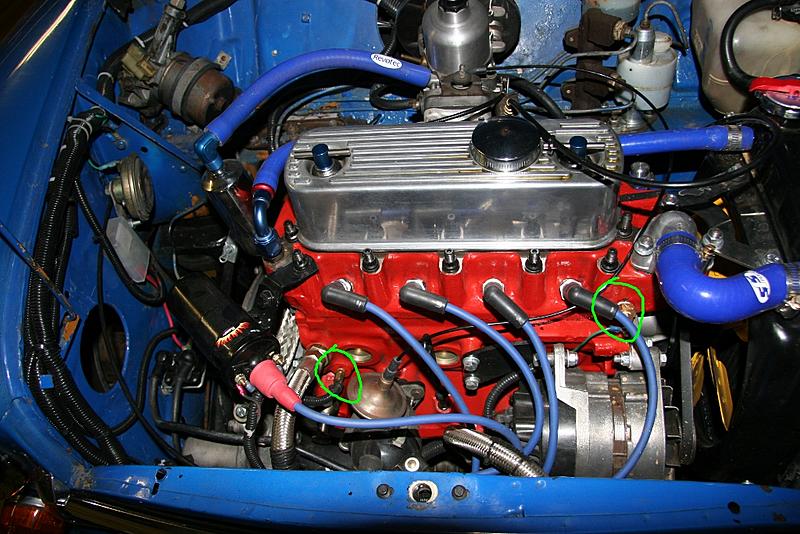

The AutoMeter gauges I used are from the 'Traditional' family of gauges. I believe I bought them at Summit Racing. You can go to www.summitracing.com and search for 'autometer traditional' to see all of the gauges in that family.
I'm attaching a couple of pictures. The first has the oil pressure sender (left) and engine coolant temperature sender (right) locations circled. The second picture shows the pedestal mounted tach.

awesome stuff so did u use the sensors that came with the guages and those fit those stock locations or did u get a different type of sensor...also where did u run the voltimeter to?the battery or the alternator?sry for all the questions ive never dealt with a car like this guage wise and its a rather simple wiring set up compared to my R53

The AutoMeter water temp and oil temp gauges came with sending units, and I used them instead of the original because they need to be matched with the gauges. For a short time, I ran the Smiths ECT sending unit and it was nearly pegged. Once I swapped in the AutoMeter sending unit, the gauge worked as expected. IIRC the water temp sending unit threaded in without issue, and the oil pressure fitting was a different thread pitch, making it a little more difficult to get plumbed correctly.
The two gauges in the main gauge pod are a drop-in fit for the original Smiths gauges, and are the 2-1/16" size. The voltmeter is effectively connected to the switched 12V coming from the ignition switch. I say effetively because my Mini has a Painless wiring harness with fuse block, so it has a dedicated voltmeter signal wire.
You will want to use switched battery voltage for the electrical power to new gauges (unless they're Smiths gauges). The output of the voltage regulator in the speedometer is used to power the electronic gauges for the stock Mini configuration. I would suggest bypassing the voltage regulator and using switched battery power directly to aftermarket gauges. Just my $0.02
Good luck!
Jeff

was the thread pitch on the oil pressure sensor off by alot or did it not cross thread?is there a switched battery wire in the stock harness or does one have to be created?

I only had a problem getting the oil pressure fitting into the block. It _seemed_ that the threads were not SAE and were not metric. I tried and tried to find thread pitch/count information for the oil pressure sender to no avail. In the end, I took a gamble and theaded the sender in to the block without issue. Note that this was right before I had the engine completely rebuilt, so I was not concerned with metal debris going into the engine internals. Water coolant temp sensor was no issue.
Capt_bj is spot on with the wire color convention used. When in doubt, put an inline blade fuse holder between the source and your accessory if you are not absolutely sure it's already fused. It's a < $10 part, and a cabin electrical fire will ruin your day - best not to chance it.
