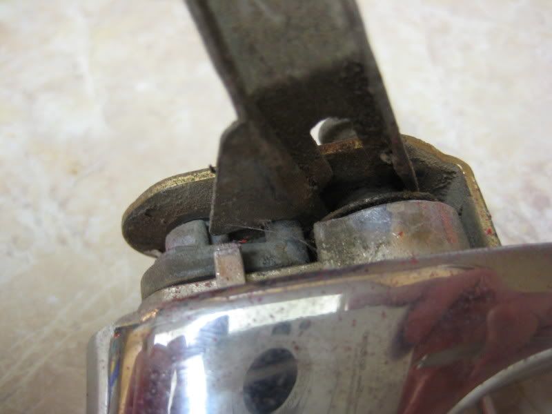

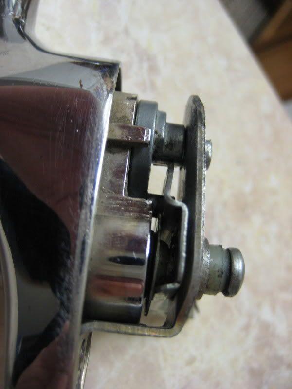

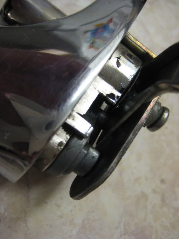

Here is how the drivers side is broken down, all cleaned up...
And all assembled!
You need to make sure that the screw on the top has some seperation between the plastic parts so that the lock slide can move back and forth!
Make sure you apply some lubrication on the plastic shaft as well, so it doesnt seize up or anything
And all assembled!

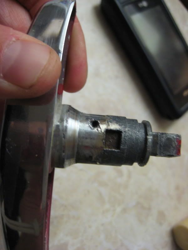

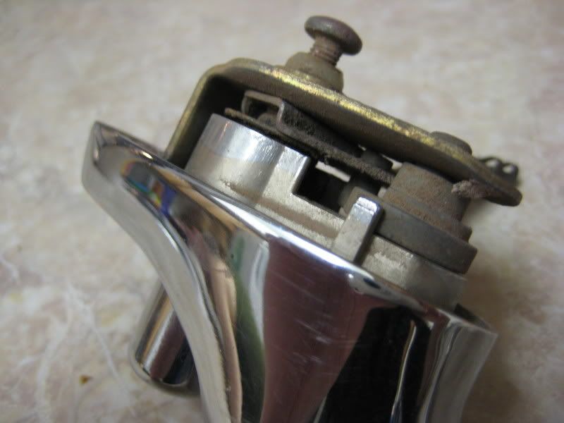

I haven't figured out the lock on my boot yet, as it has a much more difficult method of retaining the cylinder, you have to punch it out......it appears that the previous owner tried changing out the cylinder and completely fubared the lock pin that holds it in, so I'm not sure what I'm going to do.

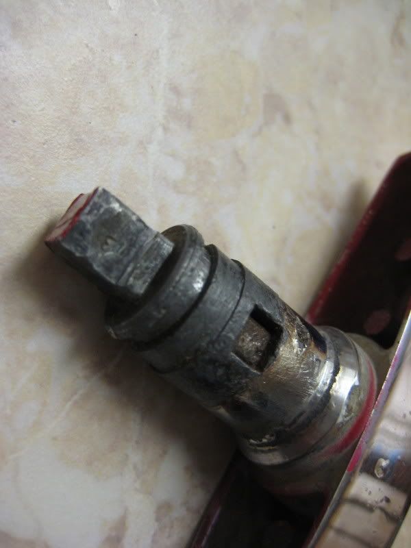

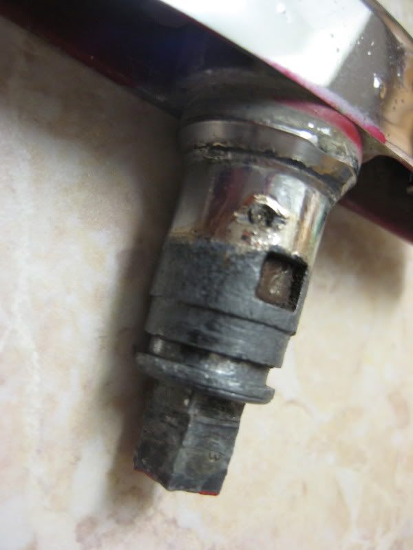

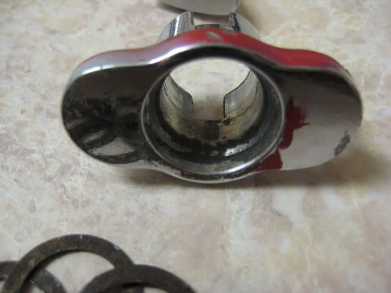

Here are pics

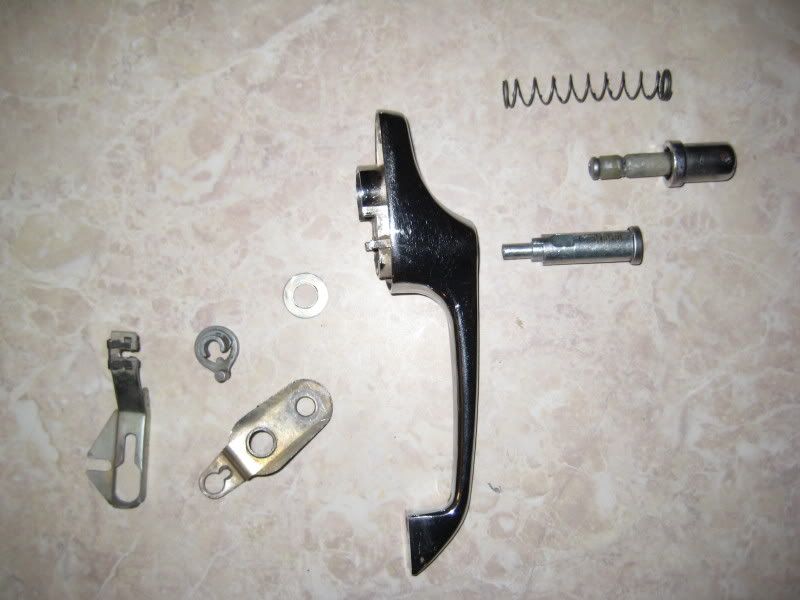

All parts dissasembled.
Pretty beat up in the guide.
The guide plate thingy that actually locks it.....Gotta paint it black.
Here are pics

that rear lock IS fugly... Did you try soaking it in penetrating oil for a while? Maybe moisture got in there and caused some rust?
I did a the cylinder replacement on my pickup recently, too, and sourced the locks through MM. The set was on sale for about $20. Mine were Mk1 style and I now have two extras since I have no trunk or key cylinder on the passenger door. Similar approach and well worth the time. I had to look very, very closely to find the little brass pin that holds the cylinder in place. It was easy to push out using a small carpenter's trim nail.
