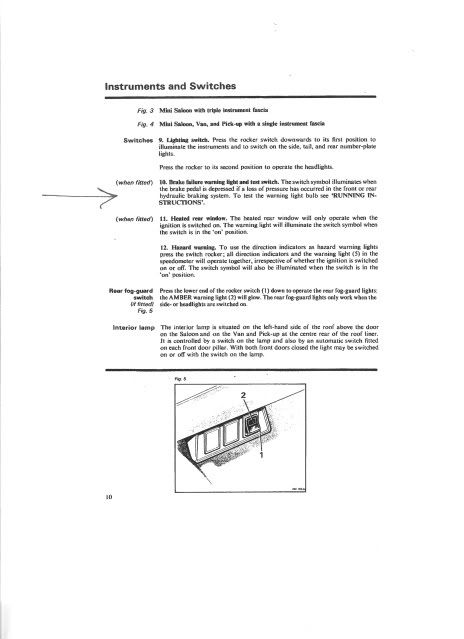

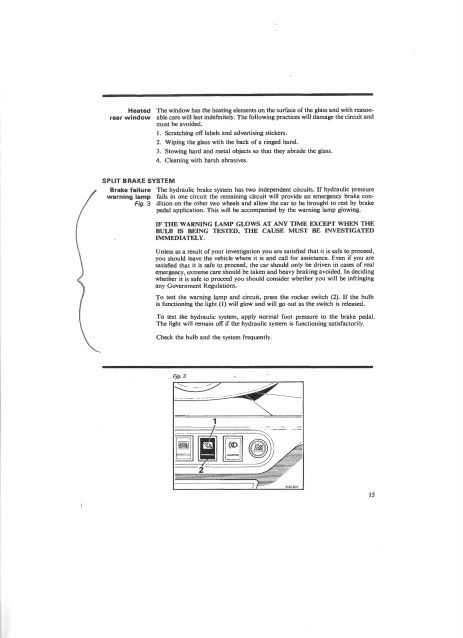

from the Driver's Handbook
pages 10 and 15 describing the Brake failure warning light from manual for 850 & 1000 years 1976 to 1980

Thank you so much! I didn't see anything like that in the Haynes manual. I think there is something wrong with the wiring to the switch panel, nothing lights up, but the switches all work.
I'll have to play with it a little more when I get out of work.
