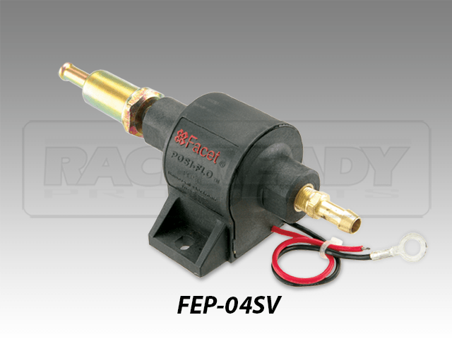

I'm running a $40 Facet Posi-Flo electric fuel pump on my Innocenti. Works fine. I also carry a spare with me, since I'm paranoid!
One thing to keep in mind if you go electric: Get the low pressure pump models, about 2-4 psi. The high pressure models (5-8 psi) are designed for fuel injection cars and if they are used in one of our carburated Minis, there is a chance that it will overpressure the float shut off needle and you will get fuel coming out of a vent. Use a pressure regulator if you have the high pressure model pump.
You mean like THIS ONE?
Going that way IS appealing... however I'd still need to pull off the mechanical pump and block the cam access hole with a blanking plate. And re-run fuel lines (which I fear may be beyond me). Anyone out there who builds race cars wanna help me?
